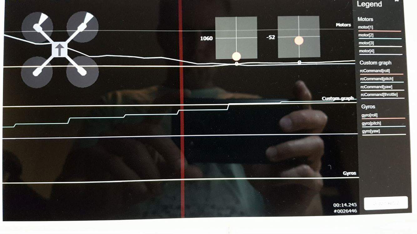

Lastly the best thing would be to look at a black box flight log. Because if it is a radio issue you will see the signal has a big delay as shown in this image
Where the throttle stick updates show a step in values rather than a smooth transition. This is from a customer issue we had and of turned out to be a faulty radio causijg this.
