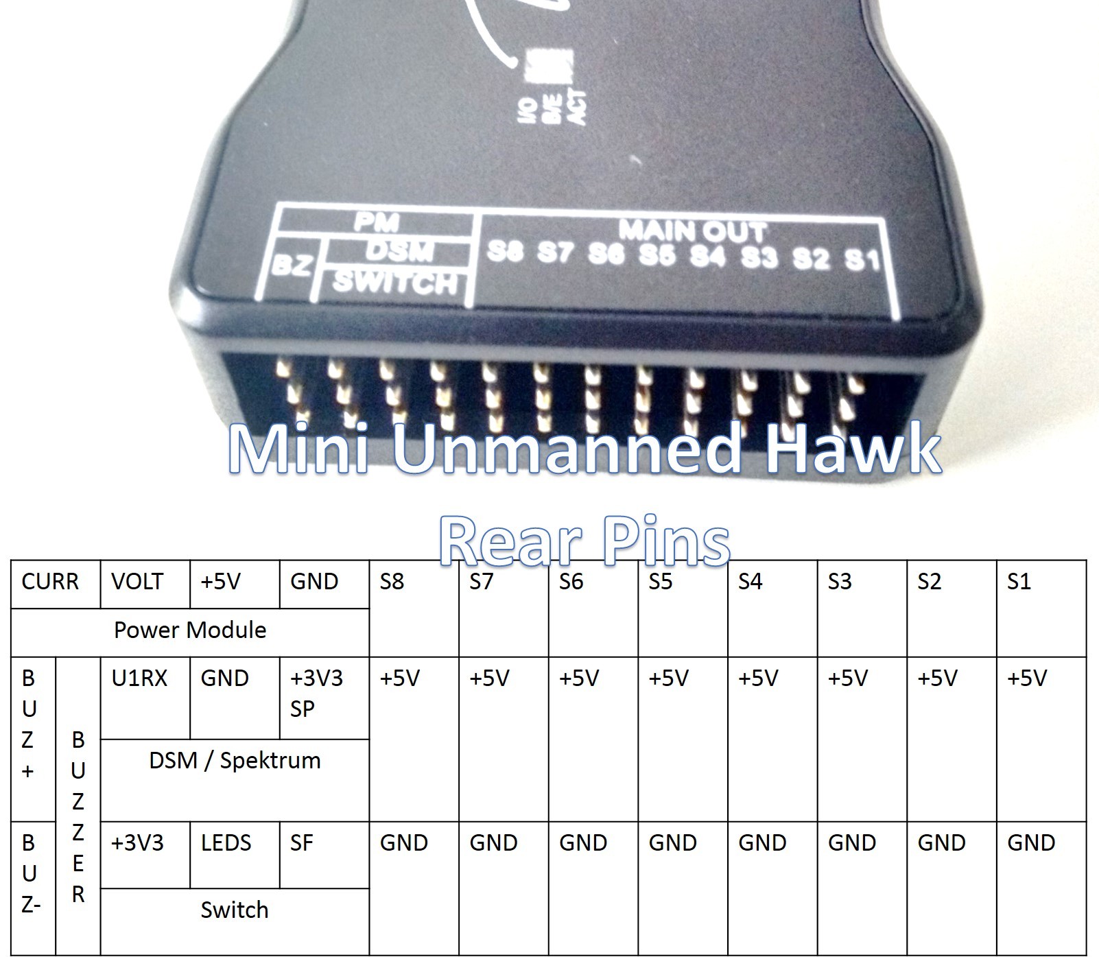

Mini Pix Port Locations
The two tables below show you the output and input pins on the mini unmanned hawk. As you can see this board has all the same number of connectors as the Pixhawk autopilot, but instead of being on the top of the pixhawk board, they are located on the front and rear.
Because of this you must take special care to make sure that you connect everything the right way around or you could damage your mini unmanned hawk board.
