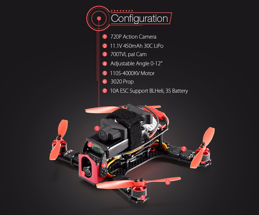

I can't get rid of pitch drift. ( Straight back )
Eachine racer 130
BF 3.1.7 & 3.2RC3
Center of gravity is good.
Stock (PIDs)
Quad starts drifting back after a few seconds of flight. From a little drift to a lot of drift after a min of flight. After landing unarming and then rearming quad starts out good then goes thru the same cycle again. All indoor flight no wind.
All stick inputs on receiver tab are 1000 low, 1500 Center, 2000 high.
Using turnigy evolution with fs-a8s receiver.
I have flash and reflashed betaflight.
Could the location of the receiver be screwing with the accelerometer?
(CONFIRMED NOT RECEIVER POSITION)
Thanks in advance for any help.
