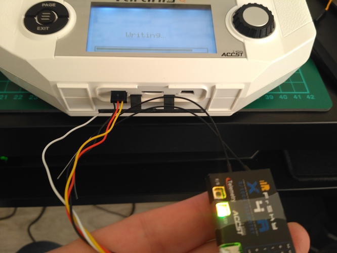

Created an account just to reply to this post as i was having the exact same problem. I was trying to flash a X4RSB receiver with non-eu firmware using my Taranis X7, but to no avail. After several hours i started pulling my hair out, was about to give up when i decided to stick that damn servo cable into the “unused” TF port on the bottom of the radio. Pressed “flash ext. device” and to my gigantic surprise it started writing the firmware into my X4RSB. Unplugged, bound successfuly. Correct pin order is GND, +5V, SIG, as on the photo.

Had to create an account to thank you for this post. I was getting frustrated and started wondering if what FrSky call the “smart port” would work and was going to start poking around with my meter.
Saved me a lot of headaches, thanks.

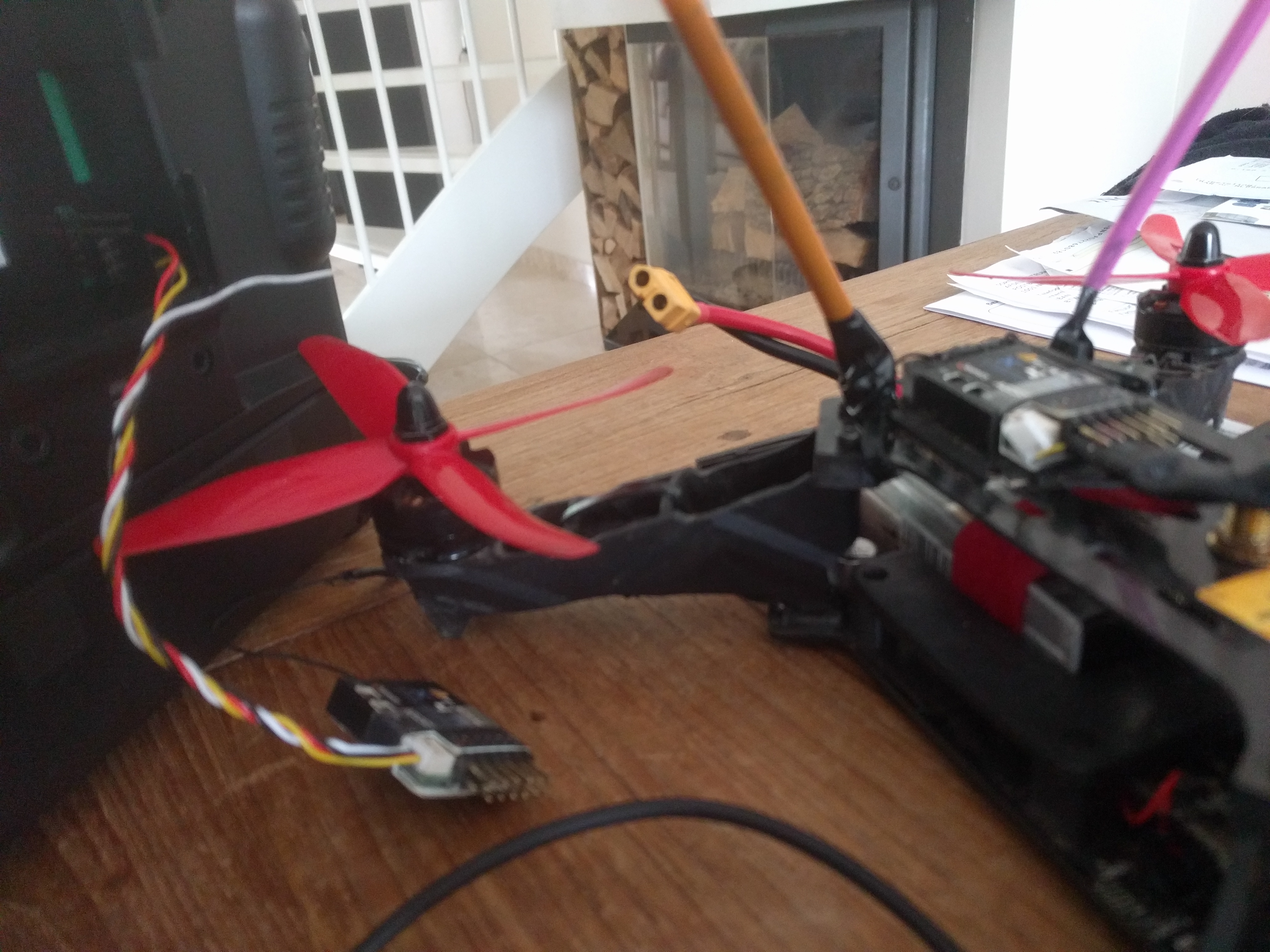

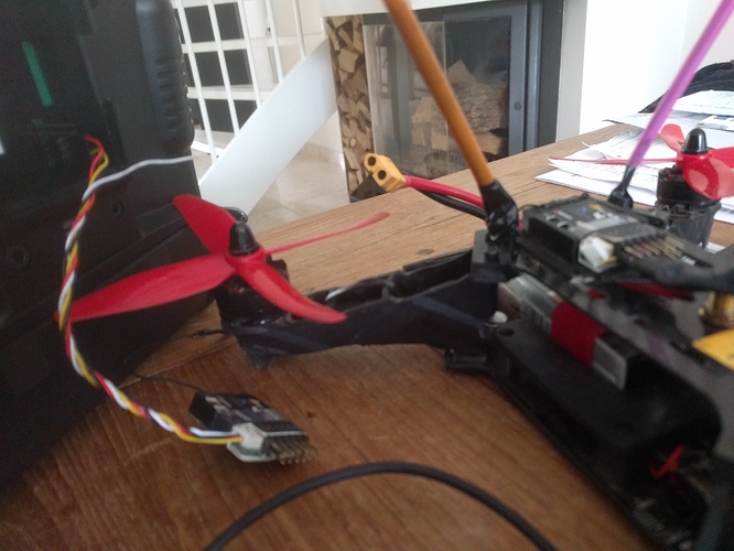

I bricked 2 x4r-sb’s!
I read the responses and your Howto.
I followed it to the letter.
The first x4r is from China and wouldn’t bind. So I thought I needed to update. I did.
The progressbar started, red and green lights flickered, then it ended with the error “defice refused the update” I downloaded this firmware from FrSky:
X4RSP_EU_V21_build170322.hex.frk
Which should be the right one.
When I power up the receiver it’s completely dead. If I try to update it responds: no response, can’t update.
I thought I might have bricked it because I didn’t fully attach the connector to the Taranis. I tried again with my “old” receiver (chopped of the antenna’s, bought it in NL, never messed with the firmware). It bricked the same way. So I have 2 receivers bricked.
