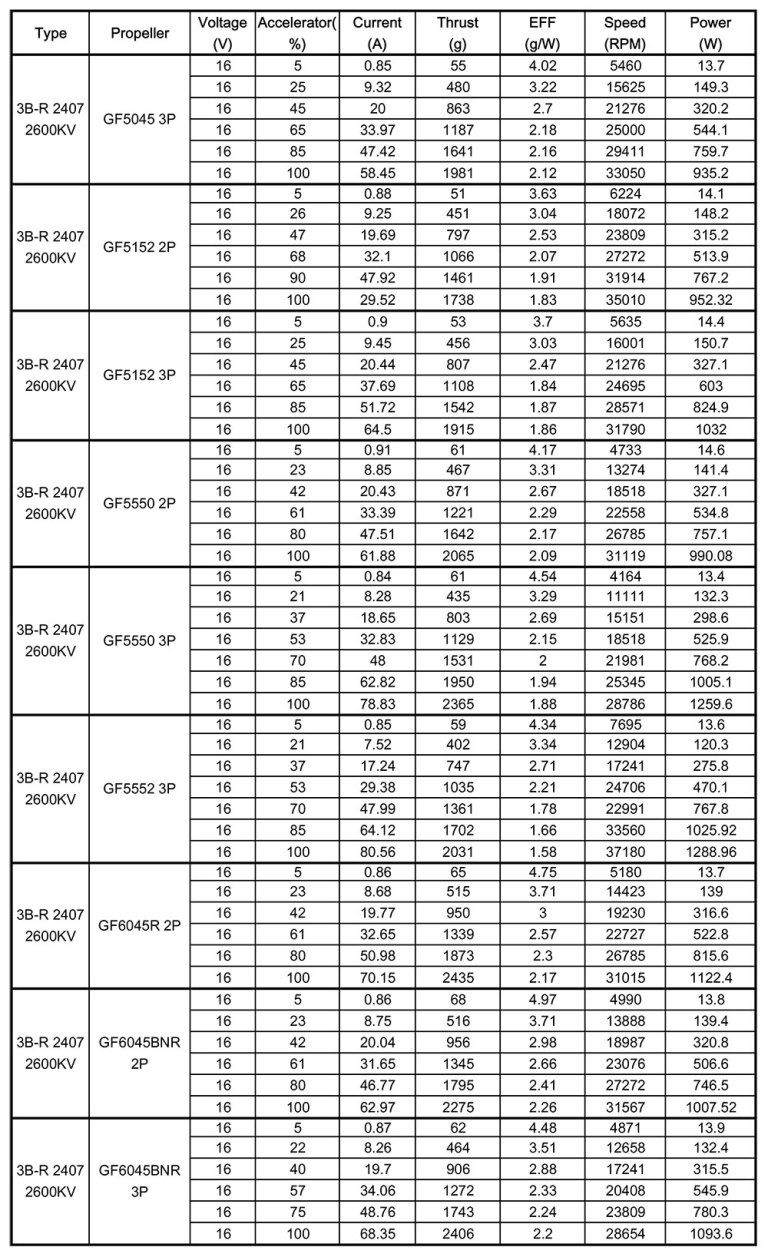

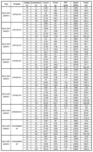

and heres the published thrust test for the motors straight from BBB’s website. The amp draw is around 40-50a after applying a 70% bias… hopefully that holds true and not more lol
Wow those are some seriously amp hungry motors… up to 80A draw I saw on the table…I suggest you do some tests before going crazy on the throttle stick to see how hot your ESC/PDB get.
