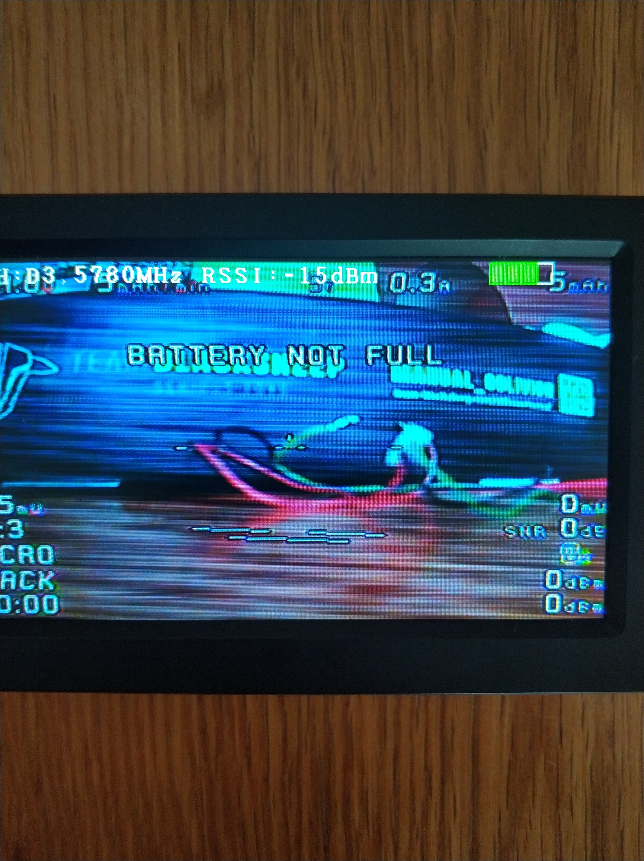

Last time I went flying I went to try the TBS Oblivion. However, the Fatshark Goggles video feed had horizontal feeds across to the point I couldn’t really see where I was flying. Once back home, I’ve changed the VTX cable, the camera, reflashed the TBS Core Pro, then the flight controller firmware. All with zero luck.

Photo attached is from another monitor, but it shows the exact same problem I was seeing in the Fatsharks.
its your camera
it looks like your on the right VTX channel and the OSD is clear.
Theres something wrong with camera.
Have a look at its connections onto the board.
You could try soldering it directly to the VTX…
The OSD will disappear but your be able to see if your camera feed changes

Tried a different camera plugged in and same issue. I’m wondering if the FPV Vison part of the powercube is fubar

I assume you have that issue before the motors are spinning? And what happens if you try running on a lower voltage battery like 3s? But I suspect maybe the voltage regulator non the fpv system is having some issues. Assuming it’s still under warranty and you don’t have any obvious signs of a bad crash TBS /retailer should offer a replacement to you.

The issue occurs as soon as the Oblivion powers on, and it passes all the self-tests with no errors.
