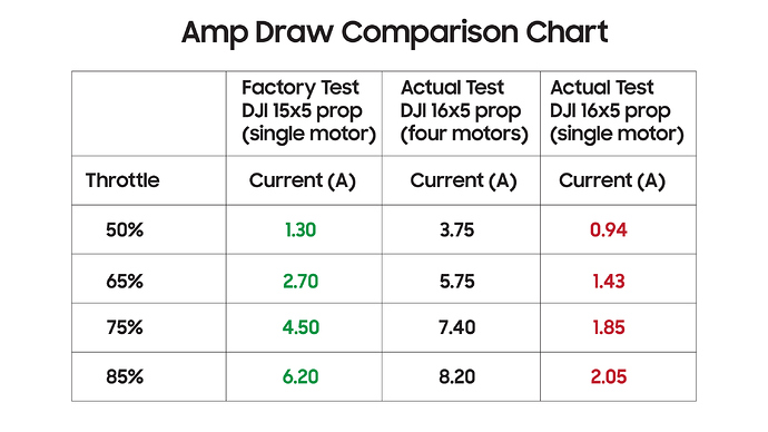

Ref: The chart you sent showing current draw: The figures in the right-hand column - are they showing the current for one motor only, or did you test all four? It might be informative if we could see the current draw for all of the motors. (I’m thinking maybe something is wrong in the circuitry between the PDB and the ESC’s - like maybe in the frame deck that the ESC’s are soldered to. But then, I’m kinda new at this drone stuff, so maybe I shouldn’t sound of here…)
Hi Jerald,
Thank you for your suggestion, I’m actually using a 4-in-1 ESC, so I haven’t had to include PDB wiring in my design. The central column shows the amp draw for all four motors, and the column on the right shows the amp draw from each (all divided by 4). I didn’t include the power draw of the FC and receiver because 0.19A is negligible. The column on the left is based on the factory results published online:

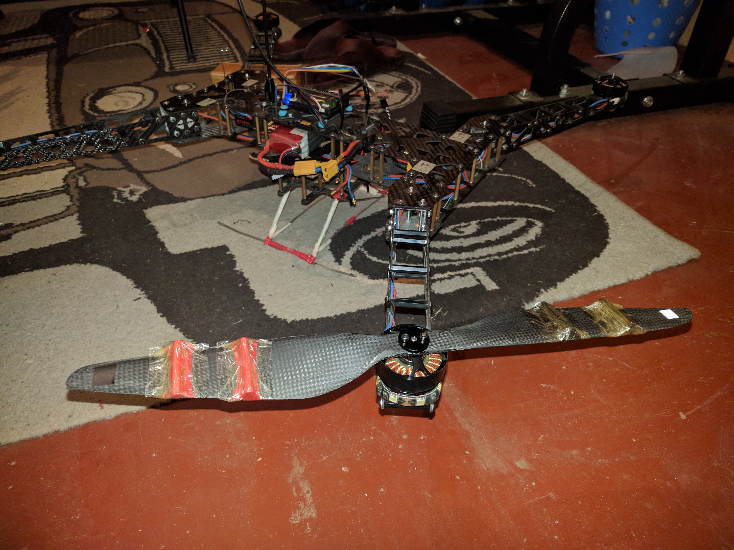

So to dispel the myth that too big a propeller somehow causes lower current draw, I attached 20g of weights onto the propeller (total prop weight 47g).
The motor went from drawing 3.9 amps to 4.8 amps at 100% throttle. So if my 16x5 prop were truly too big and overloading the motor, it should draw over 8 amps based on the manufacturer’s chart.

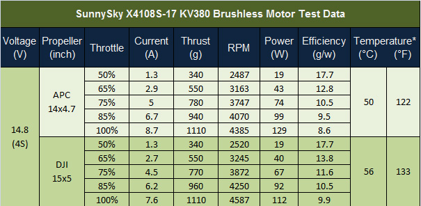

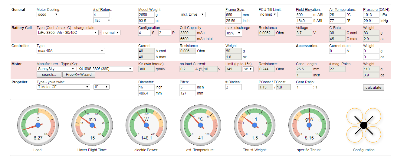

Hi, I’m just looking at a table you have uploaded and I can something that in my opinion nobody pointed out.
You want your machine to hover at about 50% throttle so at 50% throttle the thrust has to be at least 2.65kg witch is equal to the weight of your machine.
Your table shows that at 50% throttle you will get 340g per motor/prop so a total of 1.36kg (this will not hover)
I have built a Tarot 650 with 380kv motors and 14x5 props and I use 5S battery.
The total weight is 2.5kg.
I have used ecalc.ch to estimate what esc/battery/motor/prop to use.
I hope this helps.
I’ve just put your config in the ecalc.ch and it looks like it should fly, though the trust to waight ratio wants to be closer to 2.

True, with their current thrust delivery the max weight per axis would actually be about 340g. But based on the manufacturer specifications of the Sunnysky X4108S 380kV, max throttle with this prop should give me at least 1200g on 4S, not 610g. I mean, the motor itself weighs 130g, so 340g load per axis would be a ripoff by the manufacturer :sweat:

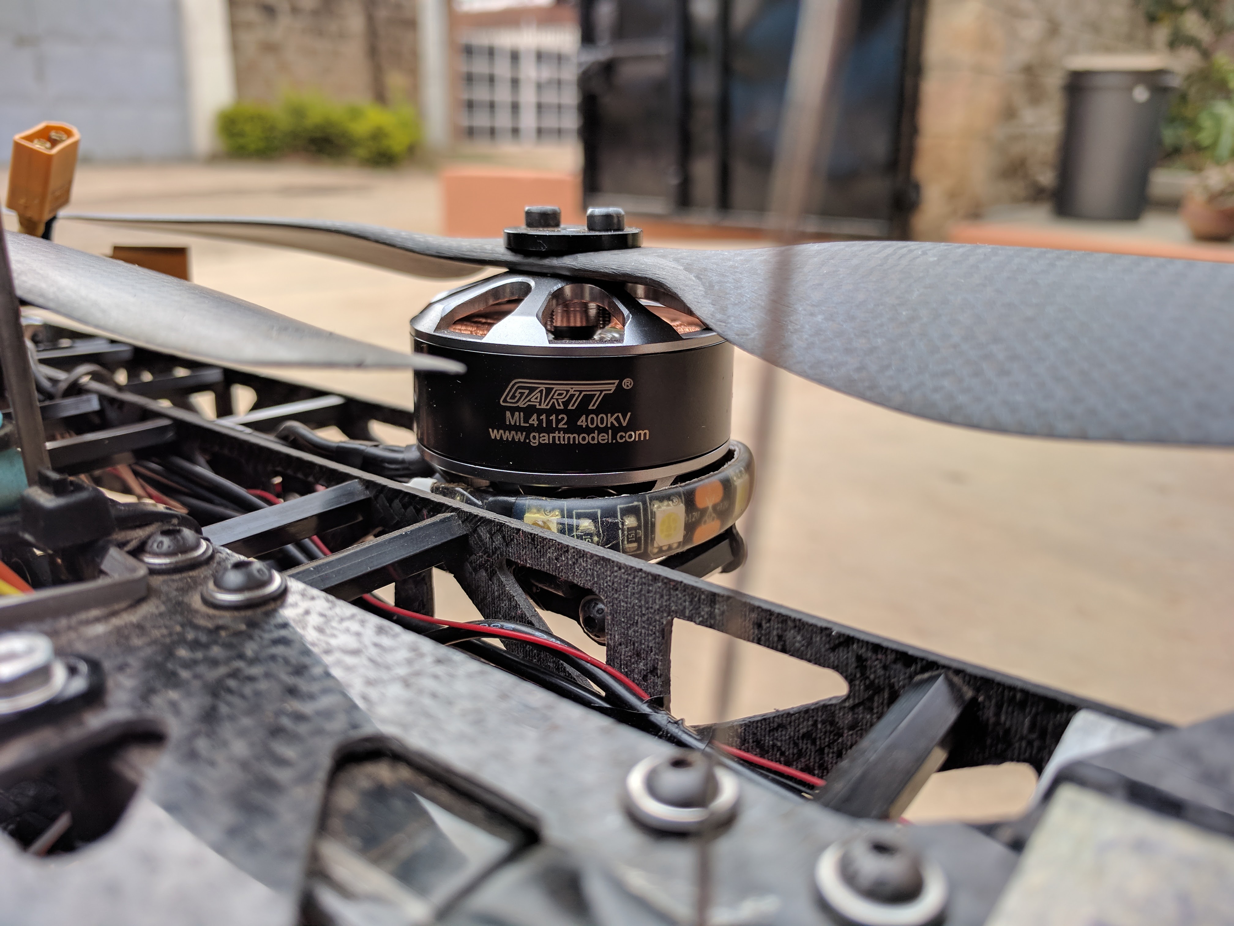

Swapping out these motors for the GARTT 4112 400KV motors instead, the difference, even at low throttle was immediately apparent. Check out the thrust test I did below:
