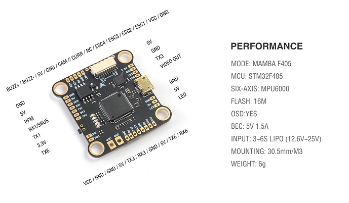

It fits in the frame okay but I have no way of plugging it in to the current connector and I believe it has a mamba f405
Use this in google images hope it helps.
mamba f405 pinout for fsia6b

Connect the IBUS from the Rx to the SBUS pad on the FC.
Then select ibus rx in the betaflight configurator.
@DoomedFPV does it matter which ibus port I connect it too? And then what do I do with the other tx1 wire? And thanks for your response. Also what do I do with the 5v and ground wires?
