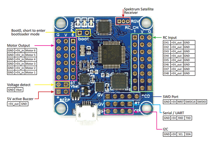

Flip 32 Board Connector Overview

There is no official manual for the flip32 board, however this post tries to cover some of the main topics that you will encounter with this flight controller. Since the best software to run on this flight controller is the cleanflight software the details on how to use the software do not depend on the actual hardware you are running it on. The only fundamental thing that is different between the flip32 and the naze 32 is the hardware layout.
However if you are looking for a more advanced manual you can also have a look at the naze32 manual (which is a board very similar to the flip32 but just with a slightly different board layout. naze32.pdf (1013.9 KB)

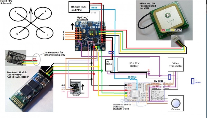

How to connect everything to your flip32
This image might seem complicated at first, but it provides great detail on how you would go about connecting all the possible accessories to your flight control board, such as GPS, OSD, Bluetooth and your FPV gear.

If you use our Naze 32 diagram along with the pinout of the flip32 on this page it should help you figure it out. The radiolink RX should be setup in PPM output so that you only need to connect a sinlge wire to your flip32 onto input 1.

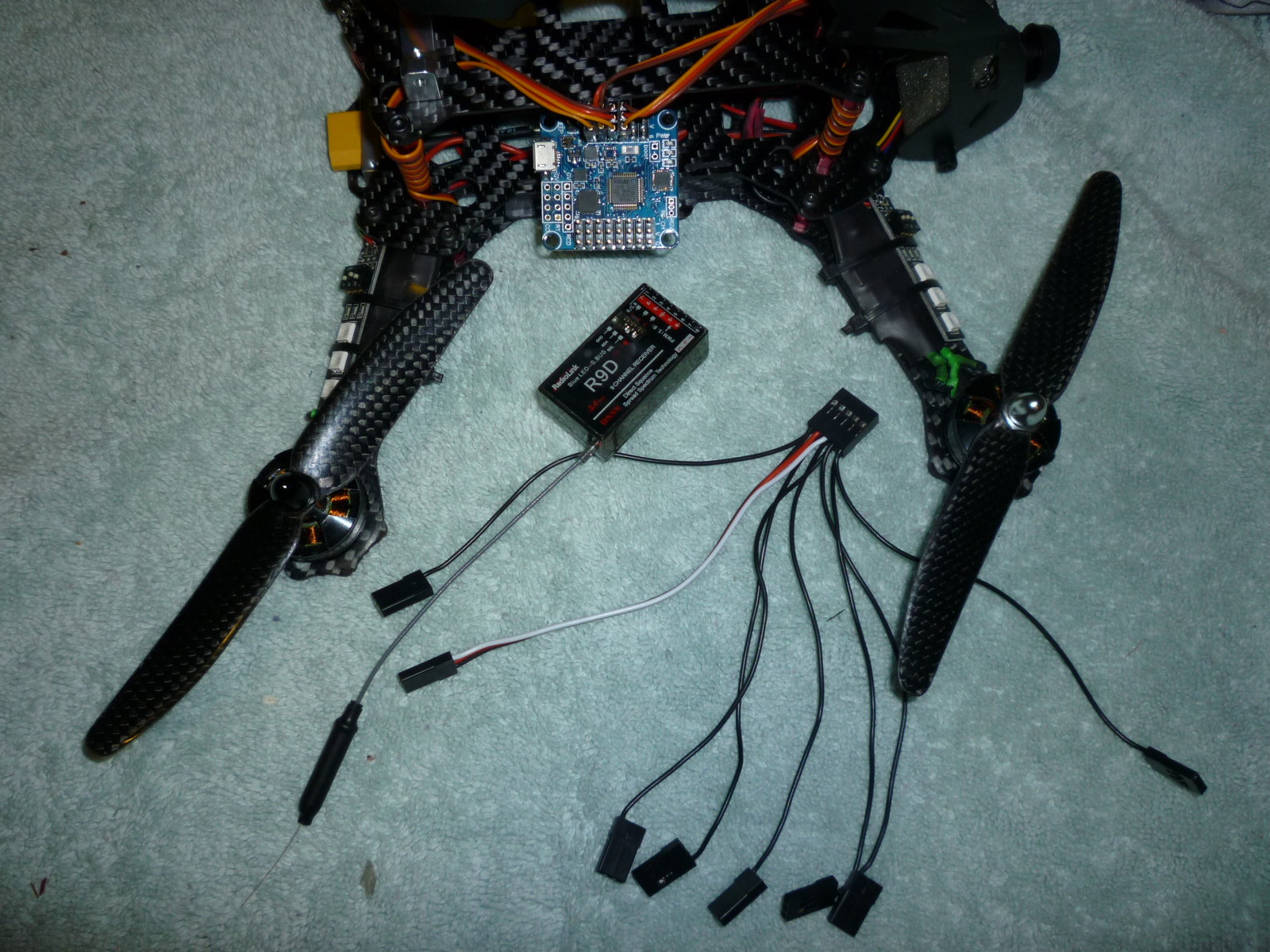

is there some place i can send you a pic of the wiring harness that came with the controller i think it may be the wrong one
by the way thank you for the reply on the power
You can attach pics to this forum, just click with upload button, or you can just copy paste it into your message

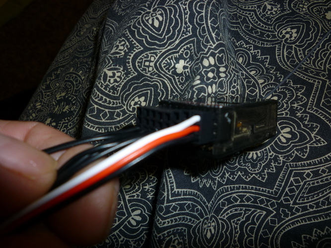

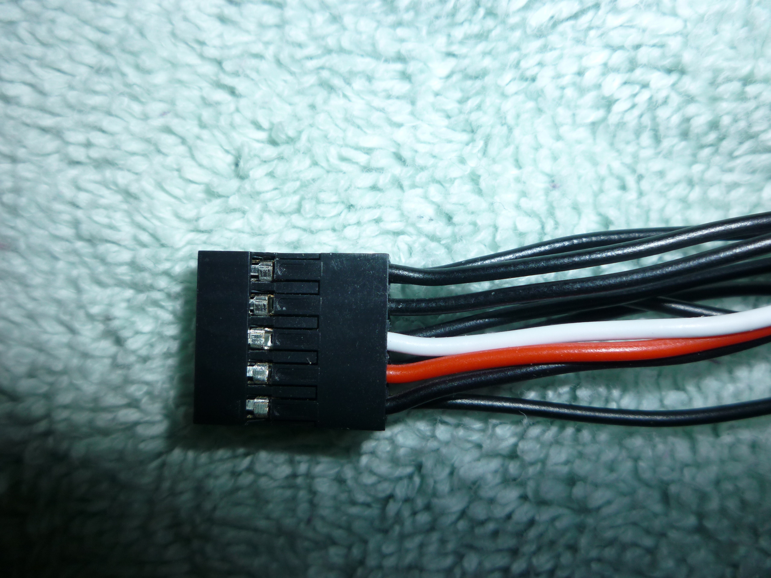

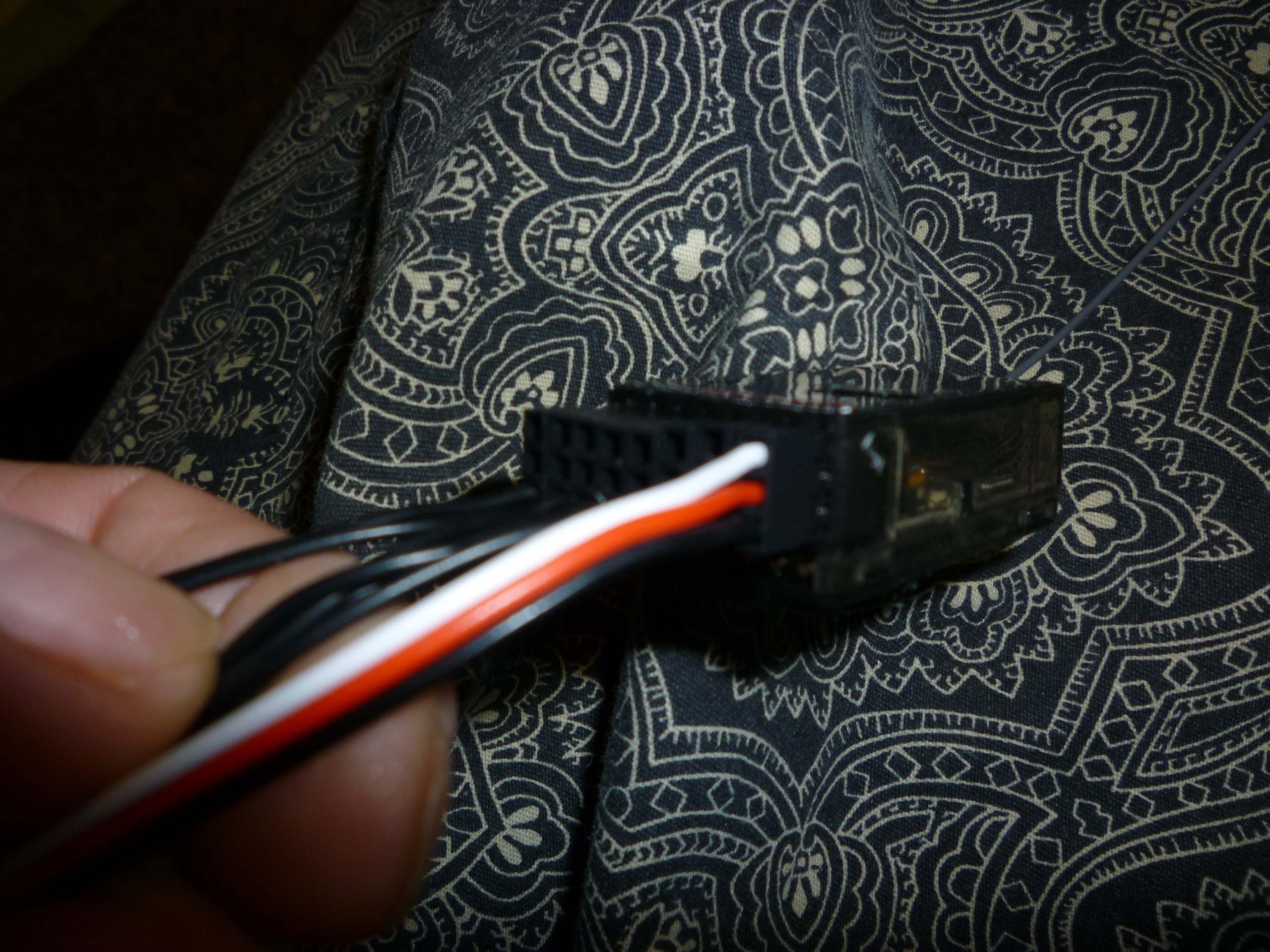

here is the pic on the cable the side that has all the leads there is only one with three wires the rest are grounds the other side is set up two prog plug the receiver is three the naze is three prog thanks phil
You just need to connect each of those wires starting with the first 3 wire cable into the RC1 channel of your R9D receiver, then connect all the others into the other 7 connectors on your R9D… I can t tell from the picture but either hte op or bottom pin will be the signal wire so make sure you plug then in the right way around.
i am still confused the connector for the control board dont match the wiring diagram and if you turn it around it dont match with receiver /just a rookie
Sorry I see your confusion, however it seems that that cable harness you have cant be used as im note sure what its for, best to use something like our FC to receiver connector cable pack.
