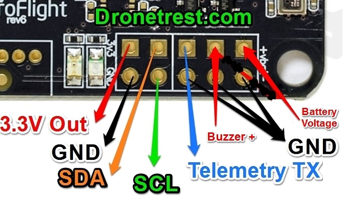

Naze 32 Revision 6 Pinout
Here is a closeup of the auxillary connectors on the Naze 32 board which include an extra 3.3V output at 100mA, a I2C connector, the buzzer connector, and battery voltage monitor pins. One thing to note is that the Frsky Telemetry pins are shared by the UART 1 TX, which is in turn shared by the USB. So if your board is connected to your PC via USB you cannot use the UART 1 ports.

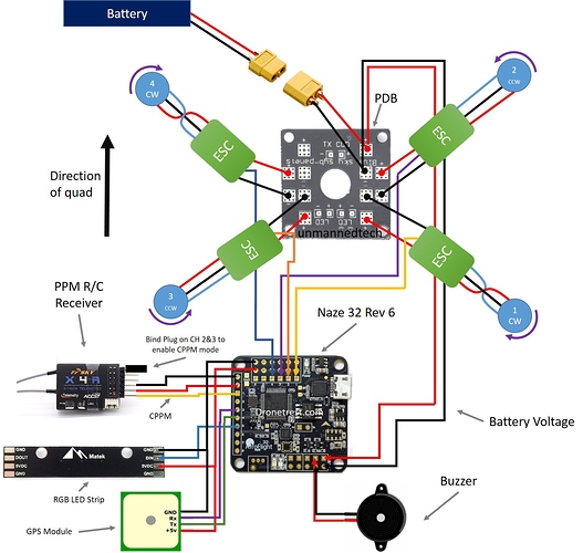

Typical Naze32 Connection diagram
The diagram below shows a fairly common setup on a FPV racing quadcopter using a CPPM receiver, optional GPS module, and an RGB LED bar.

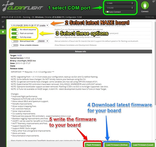

Flashing Cleanflight onto Naze 32 Rev 6
Contrary to many forums it is definitely possible to load and run cleanflight easily on the Rev 6 Naze 32 boards that we sell. Once the board is connected to your PC the drivers should install automatically. Then launch the cleanflight GUI and write the latest firmware version to your board as shown below.

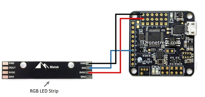

Connecting a RGB LED strip
Adding an RGB LED strip to your Naze 32 is one of the coolest features for FPV flying. Not only does it let you see your quadcopter easily, but you can also add smart features to your LED, so when you are turning left, the Left LED’s can flash. When you slow down the lights can glow bright red, just like a car brake lights.
Depending on your RGB LED strip power requirements you might need to connect it directly your battery, or BEC. In the diagram below the LED stip runs on 5V so we can power it directly from the ESC rail. The control signal plugs into RC 5 on your naze32.
Once connected you will need to configure the RGB LED strip in clenaflight. Here is a great video showing you how to do this.

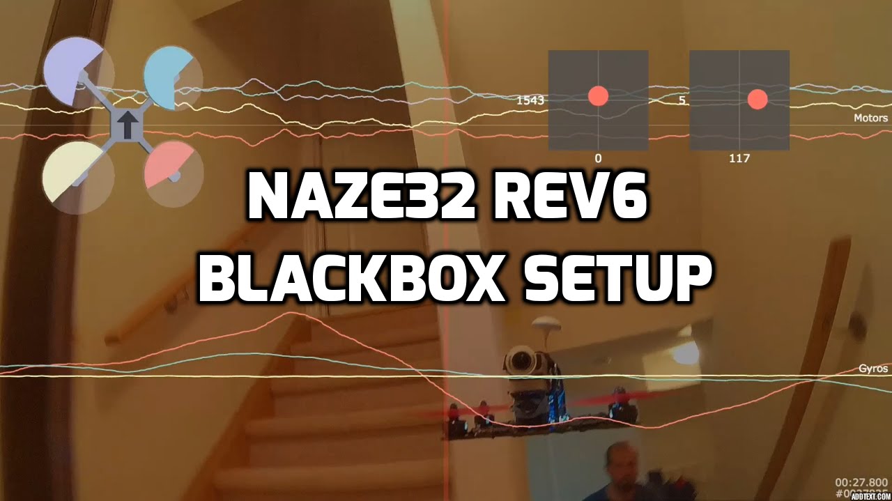

Using integrated Black-box Recording to SPI dataflash
Since hte revision 6 of the naze32 boards include a built in blackbox recorder, it is very easy to get this working. Rather than re-writing everything here is a great video by Roberto Correia showing the process of enabling the blackbox via cleanflight CLI and how to view the logs after a flight.

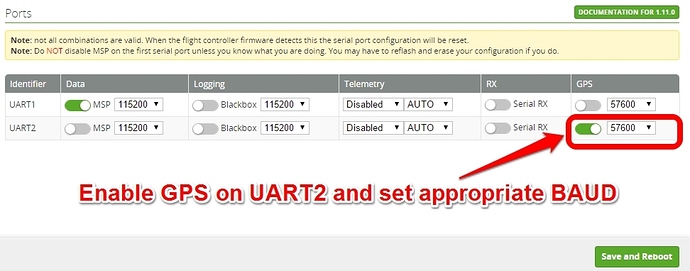

Connecting a GPS Module
If you are using a 10DOF or Full Naze 32 board then you can add a GPS module to use extra flight modes. Connecting it to the UART 2 ports is fairly easy and straight forward as shown in the image below. You will need to power the GPS module from the ESC rail.
Once connected you need to enable it within the cleanflight GUI. The important thing is to make sure the baud rate is set correctly within cleanflight to match the baud rate on your GPS module. If you are not sure you can play around with teh various baud rate settings untill one of them works. However most modules run on 57600.
Once the serial port is configured, you will need to set the GPS settings in the configuration tab.

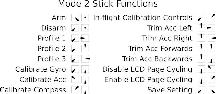

Make sure you have performed sensor calibration?
If you have not yet calibrated your accelerometers, and compass (only on 10DOF boards) on your board. An easy way to do this is to make sure your multirotor is on a level surface, with battery connected. Then on your R/C controllor move the sticks to the appropriate positions as shown in hte image below for the Gyro and ACC calibration:
