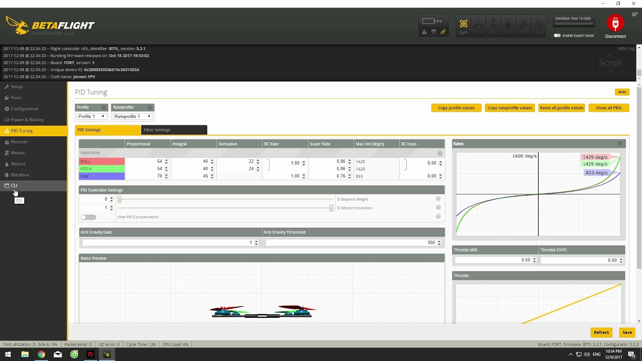

I also watched some youtube videos, there they say you can just connect it trought that button tho:

But then the motors didnt work, so i looked it up Google. There someone said that i needed to put a code in the “cli” so i did that…
After that when i disconnected it, it would just not turn on anymore, the lights dind’t blink and the lights dindt light up anymore,
