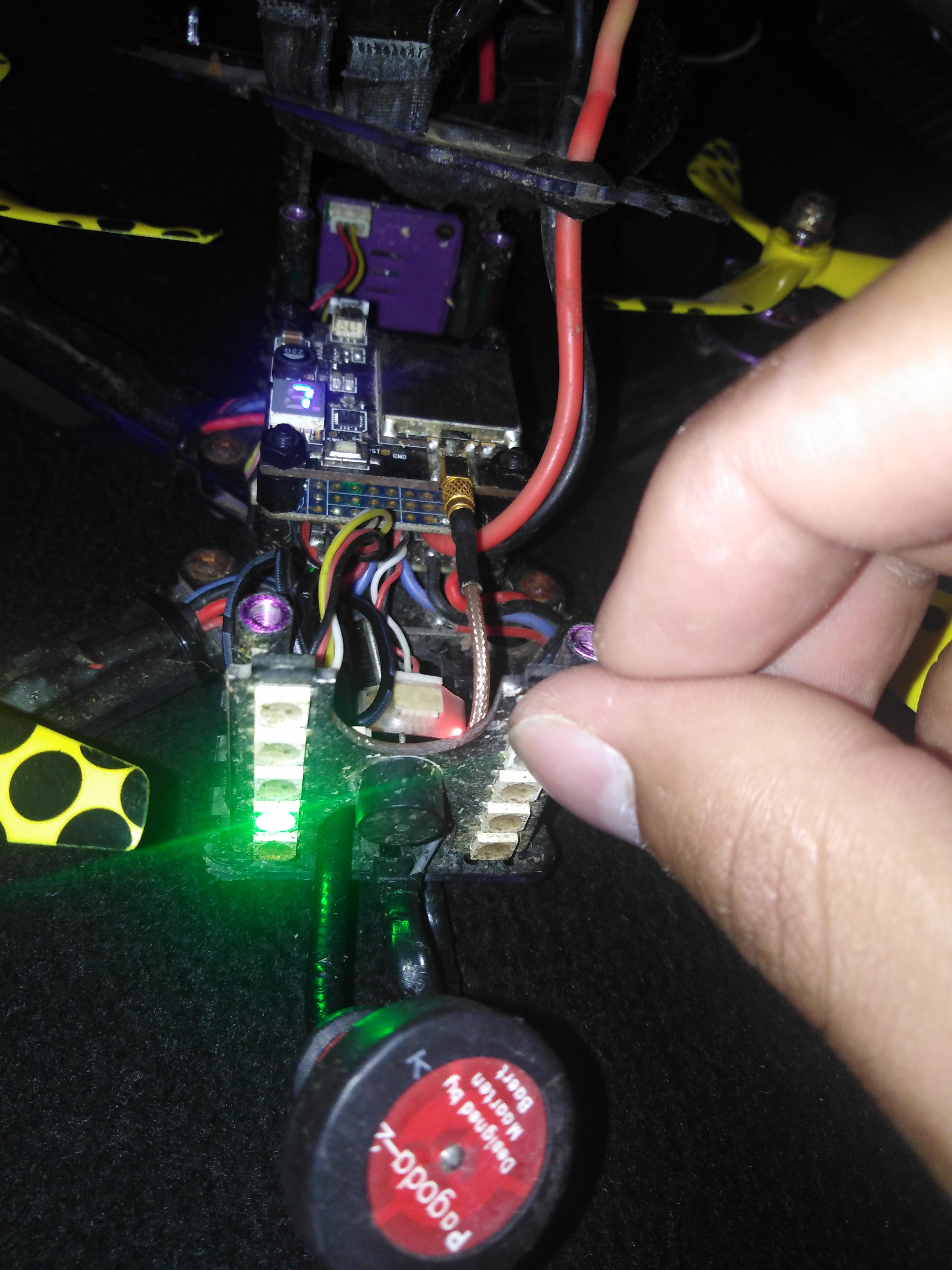

Drone wizard x220s With a green light on without responding to the transmitter
I have my Drone wizard x220s connect it to betaflight and then it looks like this With only one light on green. The transmitter connected without problem but the drone does not move

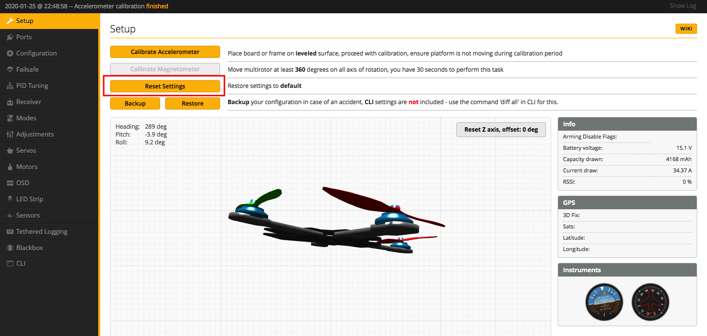

I just realized that I pressed the reset settings by mistake and I don’t have a backup. Someone has some backup.
I saw many tutorials on YouTube and so far nothing one that solves the problem
help with my configuration

as above done worry about the 1 green light that tells you nothing the LED board is probably knackered
https://youtu.be/Sumzp5VzvWk this my video

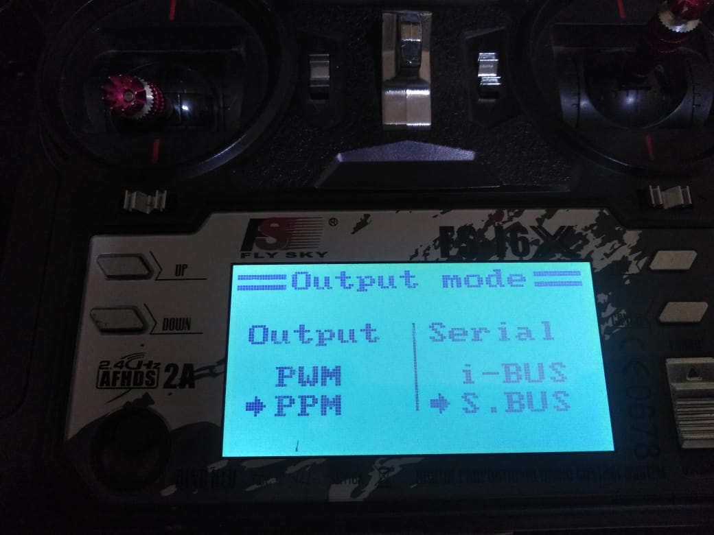

You don’t have a port assigned to a receiver and no receiver config listed on the config page!
Check what uart your receiver is connected and then turn that one on
Then go to the config page and change the receiver type to the correct protocol
You will need to save and reboot between each step

1st have you upgraded the receiver and is the flight controller a SPracing f3
