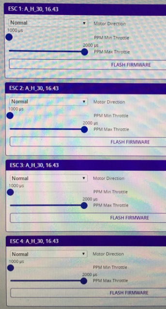

I’ve just ordered a set myself 25a. Do you still need to install software to run Dshot?? or do you just select it in Betaflight?
They already have BLheli_S firmware on them, but I honestly cant recall what version (should be latest firmware from start of JAN) our current batch have , and what the default settings are
as when using any ESC I always hook them up via passthrough mode to BLheli Configurator (as its super easy and convinent) to make sure the motors are spinning the correct way, and all the other settings are correct like mode, calibration etc…
So am I correct by thinking - as long as they have the latest BLheli software flashed to them we haven’t the the need to flash them with anything else?
Correct, however its always best to use the latest stable version, of Blheli_S as they always have improvements/bug fixes. All you need to do is make sure the throttle range of each ESC are between 1000us and 2000us since Dshot is entirely digital
Please Note that the screenshot below is not with the Chaos Dshot ESC, these are from one of my other quads I had with my at time time! - as i think the firmware version on the screenshot has confused some people.
Is the software A H 30 format for these ESC’s. I suppose if I’m patient - once you read the software from the ESC’s it will tell you ???
Hopefully they will arrive tomorrow
It´s not A H 30 and i learned the hard way… It was C H 15 on my 25A Escs but because i was getting some desync´s i forced the the A H 30 and now i can´t connect to escs… the startup tone still beeps but after that, nothing. Guess i killed the bootloader.
Is there a way i can reflash the correct Format ?
