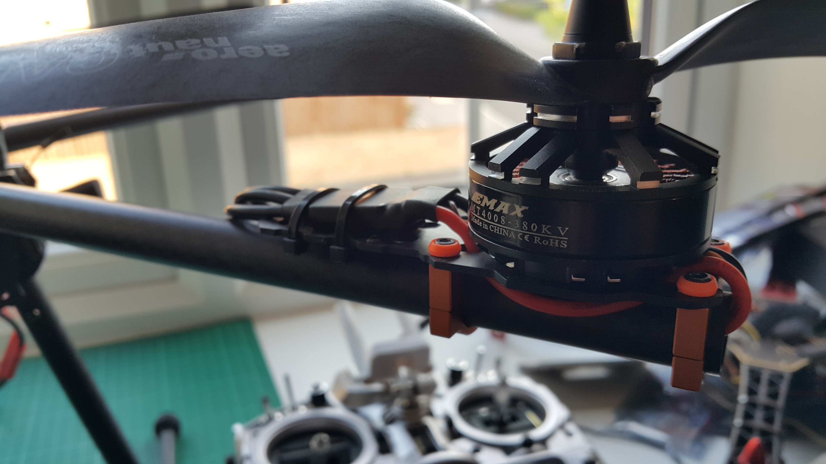

I have just fitted them on my Tarot 650 with Emax MT4008 380kv motors, so far they work very well.
I still can’t belive how small and light they are.
