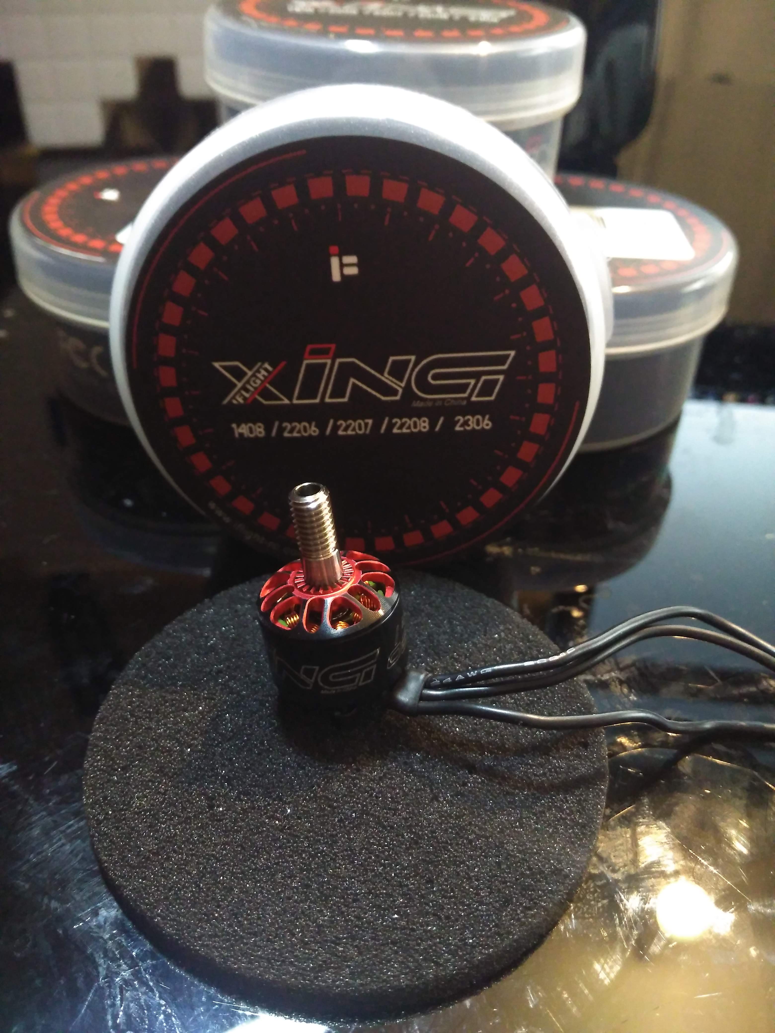

Motors :iFlight Xing 1408 Motor 3600Kv
Not only do these motors have a good track record but they just look great.
Now I went for the 3600kv versions cause I don’t need the top end speed that 4100kv motors will give me and they should be a bit easier on the lipo.

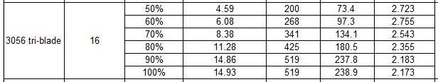

1408 3600kv Spec on my props…

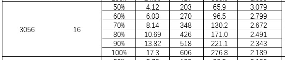

1408 4100kv
On paper the 4100kv look to have slightly lower amp draw, better efficiency and are nearly 1g lighter.
Did I miss something here?
