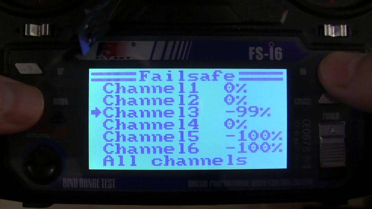

I am honestly not 100% sure with that receiver, but pretty sure its just that you need to set the failsafe on your flysky radio itself. Some other brands you can set failsafe on the receiver itself, but with all the flysky gear I have used, you set it on the radio itself. Here is a video showing you how to do that:

I don’t have that option on my transmitter (I have the 6-channel firmware). If I need the 10-channel firmware to do that, could you please find me a link to a download cable that isn’t ridiculously expensive (less than $10 hopefully). Thanks!
Do I need the 10ch f/w?
Nevermind, I do have that option. It won’t help though, because I need throttle failsafe to be below PWM 975 on my APM, and I can’t move my throttle that low. If I make the threshold value for failsafe 1000 (at the throttle’s lowest point) then as soon as I plug it in or land (when the throttle is at ~1000) it will trigger a failsafe. What should I do?

play with ch-3 endpoints., to get it below fs: value.
