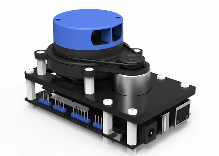

For your needs I wouls suggest the slamtec lidar. It does all of the filtering onboad and the co processor runs the SLAM (simultaneous location and mapping) algorithm to effectively output a map and the devices position within in. You can find out more about it here. It is also very affordable for what it can do.
First of all, Thank you!
Your post is very helpful! I red before about RP lidar A1 and A2 because they were affordable! RP lidar A3 was too expensive. However, your suggestion “M1M1” is seductive but the lidar with the firmware will cost me around 350$! (Delivery + customs) So it’s over budget!
I’m thinking in buying the V3 lite Lidar and i will implement it on a motor and will do the coding (it’s an FInal Year Project)!
