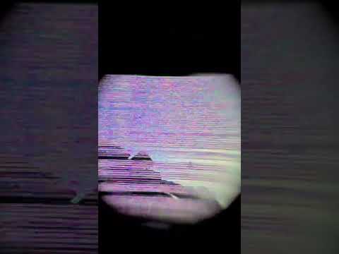

When switching to high frame rate mode in goggles there are white lines/noise shown in left screen. Right screen view is perfect.
I’m using Moonlight VTX and can run at 720p 60hz with no issues but when switching to high frame rate mode (100hz) I get the white lines in the left eye. I have tried using HDMI input from PC to rule out the VTX and get the same. 60hz fine but 100hz shows white lines in left eye.
[Same issue with HDMI input so not related to VTX](https://youtube.com/shorts/enKFR0gkj-8?feature=share)
Thanks for that, I have passed this onto Walksnail and requested for a warranty replacement, so once they approve we should be able to get it resolved for you! Otherwise they may know a direct solution for this, but based on the fact its the same when you use HDMI input, I agree its most likely a damaged screen/connector inside the goggles.
