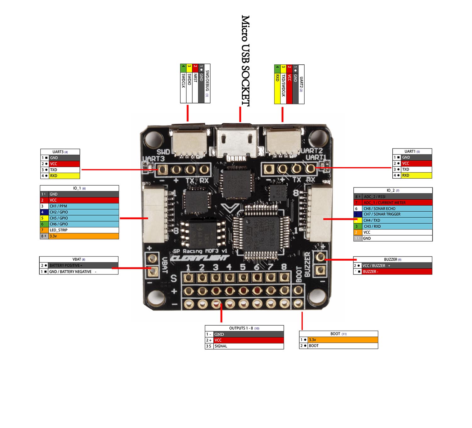

Does any one know, where i have to hook up my VBAT? I know, where i need to hook on the FC , but where on the PDB… Do I need to put the full Battery Voltage into it? I afraid, that my 4S lipo kills my FC… Thanks for your help…
Not sure what exact version of the board you have, but yes you connect the battery voltage directly to the vbat pins. 4s should work, but double check the specs to make sure it can support 4s on vbat pins. But I will be surprised if it can’t handle 4s as 4s is very common battery to use.
Thanks Buddy… wasnt sure
