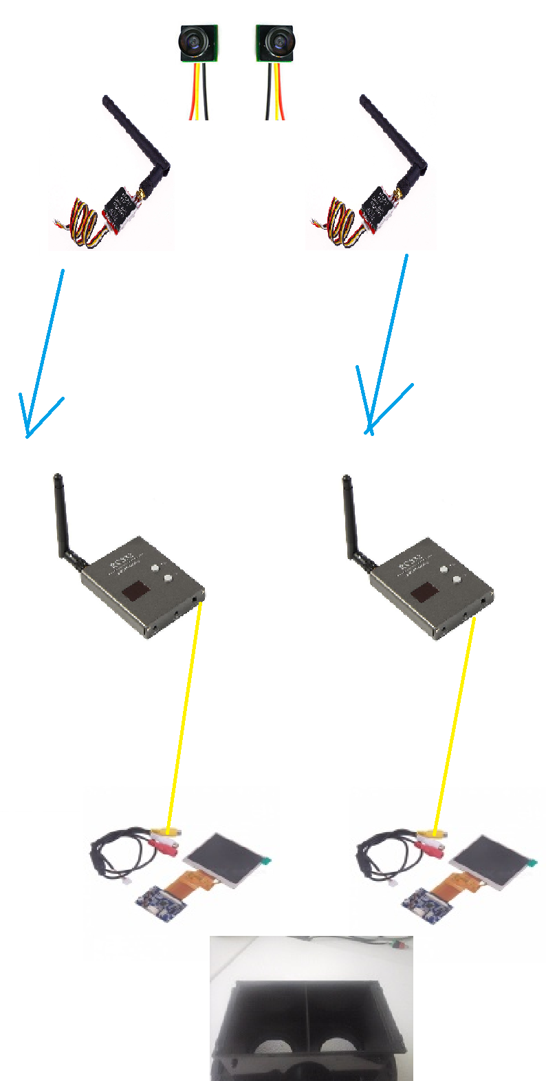

Well, the actual goal is to watch ‘stereo’.
( no problem for me to set up a double camera and double transmitter and use different frequencies )

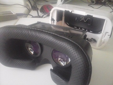

Got an old empty VR-goggle. ( had a build in split- screen and wifi android etc )
So, I could build in 2 seperated small ( say 2,5inch ) PAL/NTSC-screens and 2 separeted PAL/NTSC-receivers. 2 screens and 2 receivers would cost about 60euro, shipping included. Got the skills to do that, including adding a battery.
I’m not sure but will these goggle do the same? I think, that’s how they work? Here:

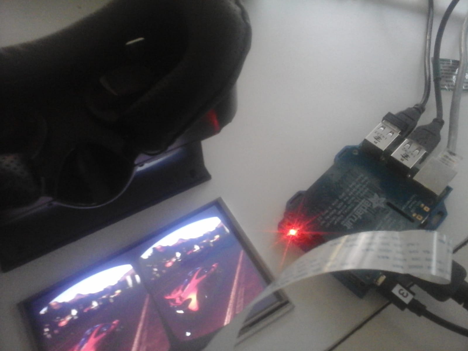

Plans have been changed, my first prototype is controlled by my Rspberry PI.
First test are impressive!
- rapsberry pi
- old vr glasses
- 5inch 800x480 tft/touchscreen ( later to be a composite video screen tft 5inch 800x480, only 13euro inlcuding shipping )
- playing side-by-side youtube test 3d videos.
Later to be modified as FPV with tjhe welknow 5.8GHz stuf!
I’m allready impressed by the result. Must say: in the set up above, 800x480 is defeinitly the minimum!!!
Final version, gets my pi zero and composit video tft.
Here you see pi 3 b. with toucscreen/tft.

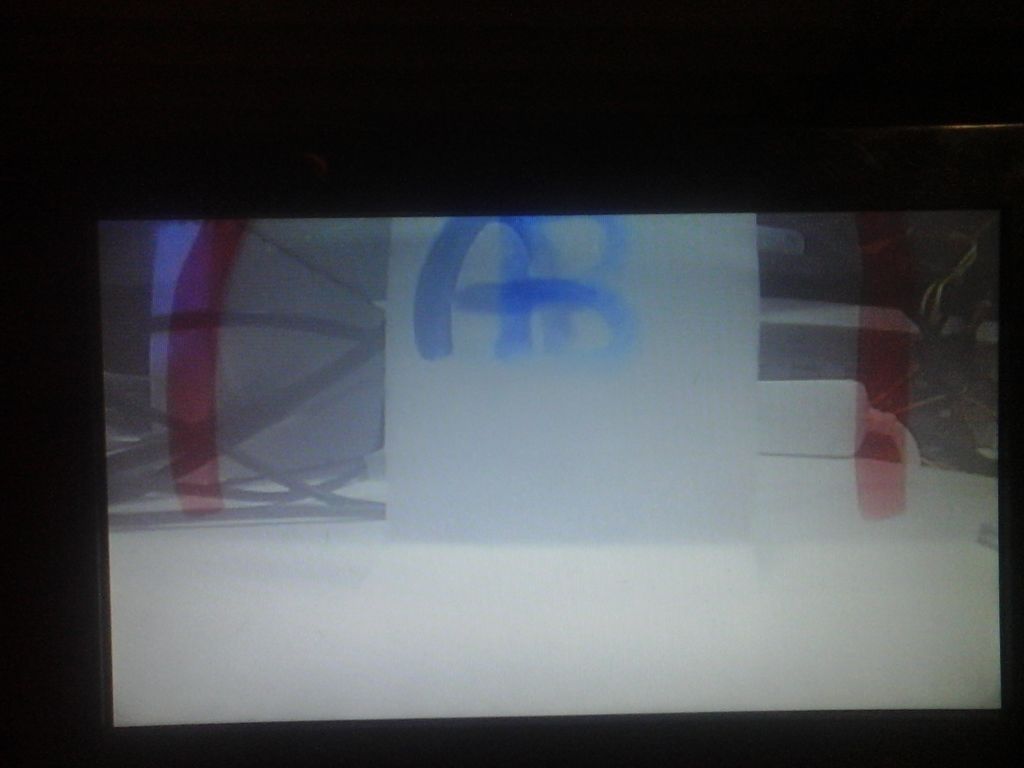

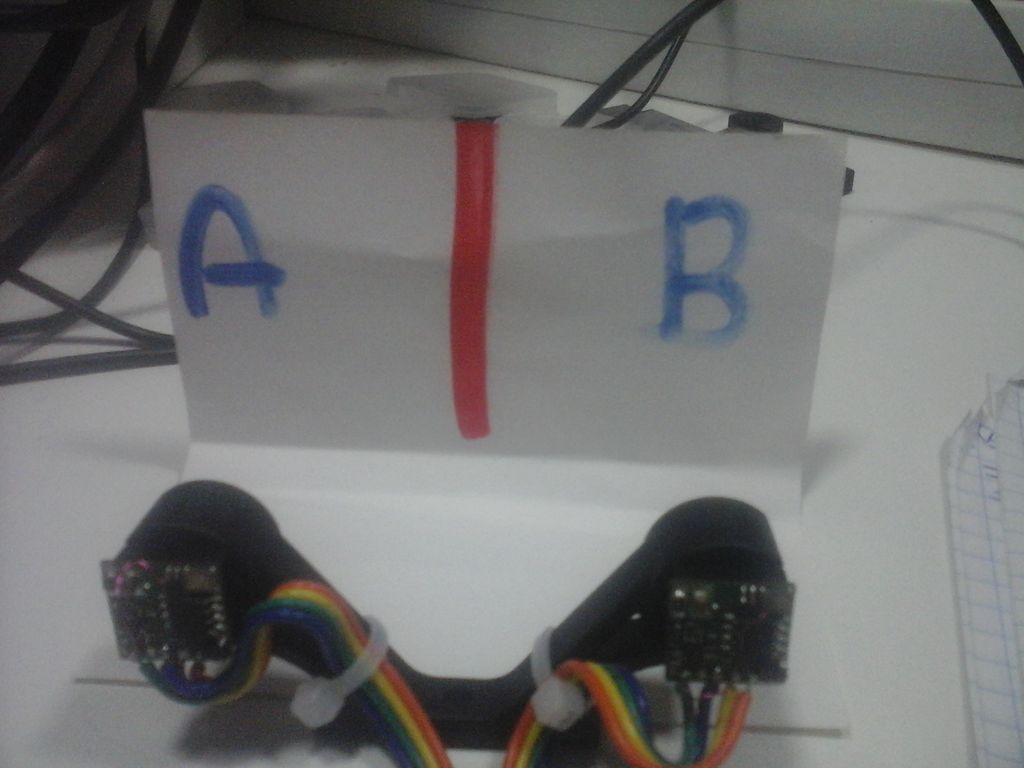

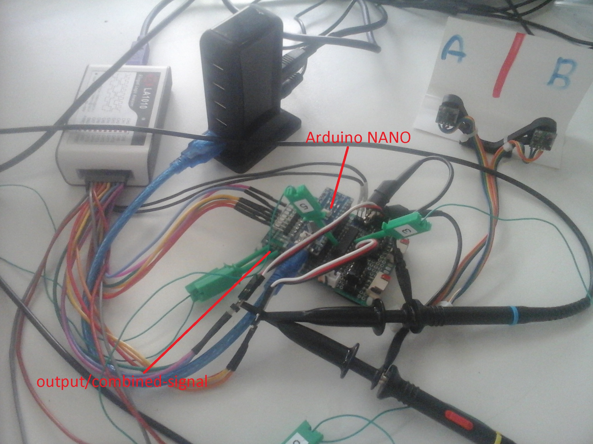

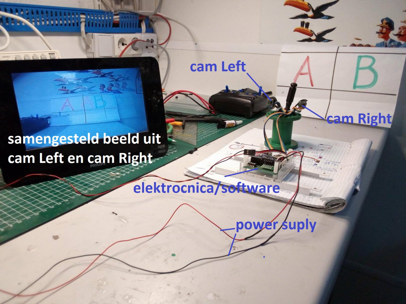

Briefly: 3D FPV. Use 2 cam’s, one trnasmitter 1 receiver. Signals of tboth are synced and “combined as 1 video signal”. Only 1 transmittyer needed ( no struggling with 2 transmitter signals). Receiver “extracts” the incoming signal to a left-eye and right-eye picture, displayed on a mobilescreen . Extraction is done by software/app.
Here you see the “combined” signal. This signal is goingn to be transmitted!
This specific setup, gives the half of the TVL.
At the moment, both cams have 600TVL.
This results in 300TVL at receiverscreen.
Later, gonna implement 2 1200TVL cams.
Have to find out if/how/etc it works.

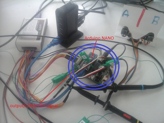

Here the pcb, for prototyping, with lots of extra measure-pins.
Later gonna make a very small one. With onlu the funcional connectors
and the microcontroller as 1 chip and not as an board ( in this case Arduino Nano, see picture )
Picture show logic analyzer plot.
At the moment, the sync is now acurate within the duration of the burst signal.

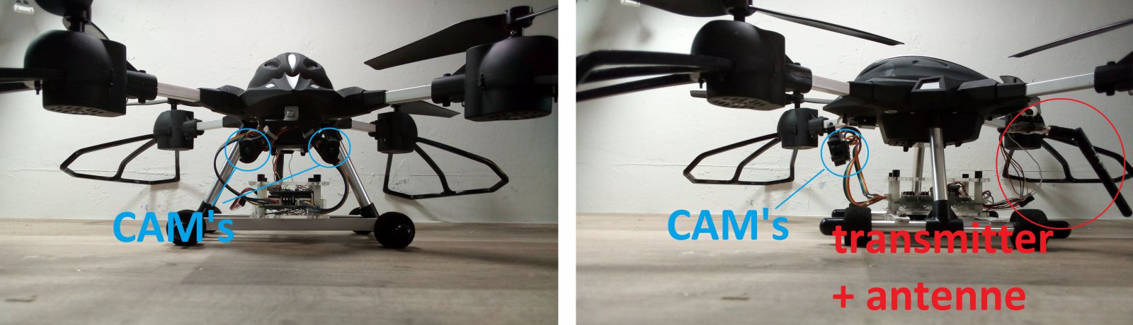

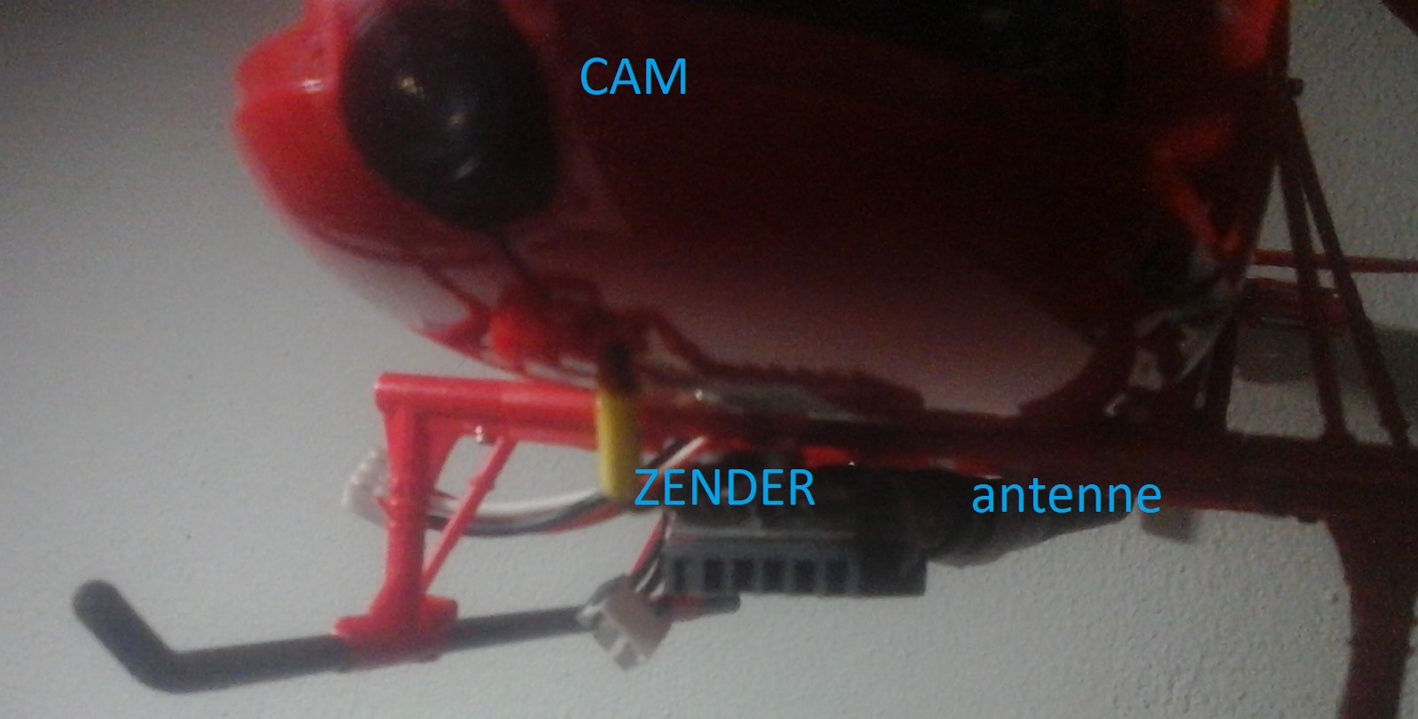

Now I got a heli with ‘mono’ FPV and the drone with 3D.
Hopefully, soon I can post video’s, so you can see them too.
For the time being: some pics…

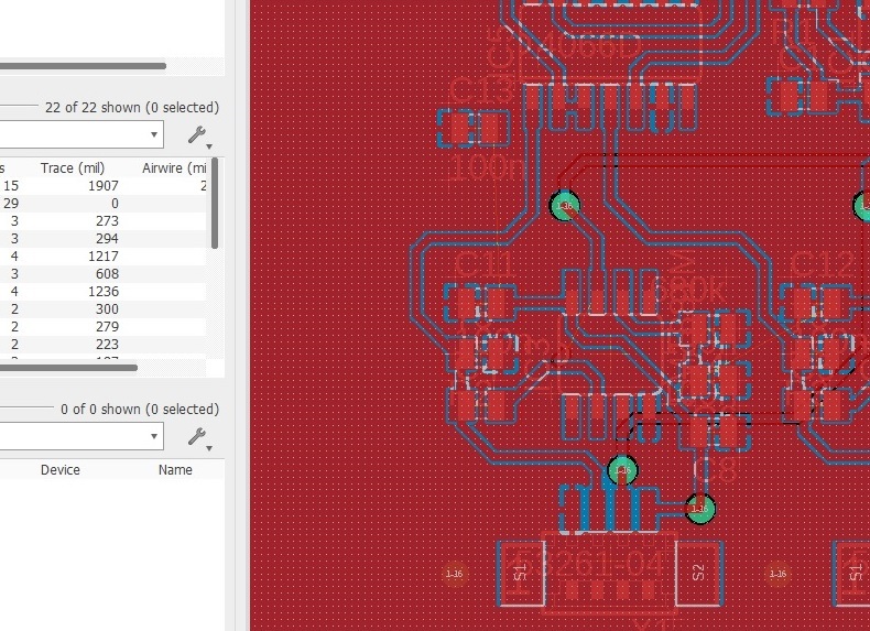

Posted this picture before, the whole V1.0 setup of the pcb. it’s a big one but ok.
Now, I’m designing V2.0, it will be about 40x40mm ( it can still smaller ).
All components are smd cased.
Not finished V2.0
The conectors have 1.27mm pitch.
There are 2 cam connectors, 1 connector to transmitter and the 1 for programming/powersuply.
