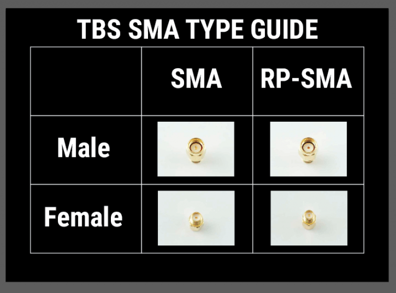

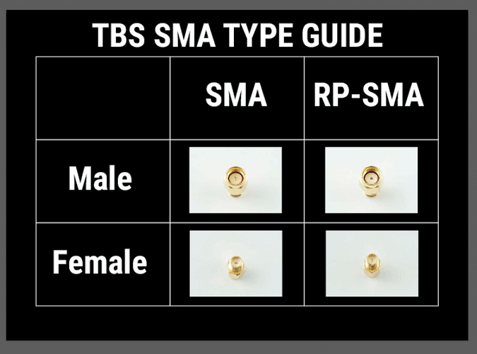

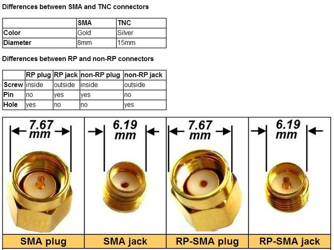

This guide might help you work it out, but it depends mainly on where the pin is, and it also seems that many people use different terminology, so best to just look at the pics to work it out.

The question if they will talk to each other is Yes
The technology is the same.
You just need to get the connections right, as per @unmannedtech1 Alex’s guide
