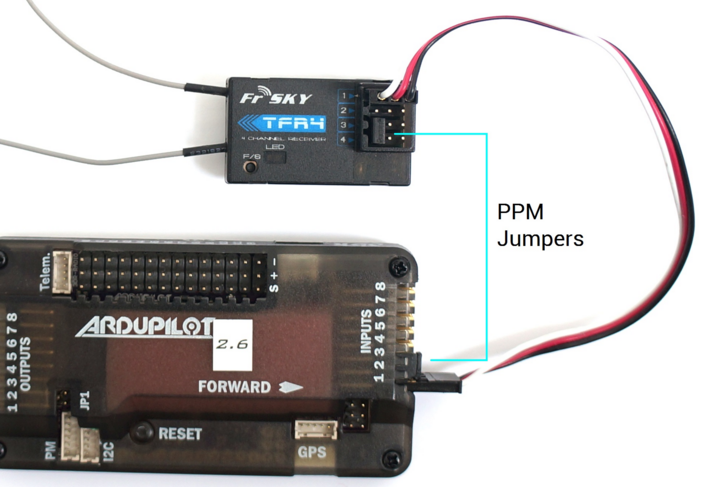

Both PPM and SBUS connect to your receiver easily with one servo connector as shown below:
