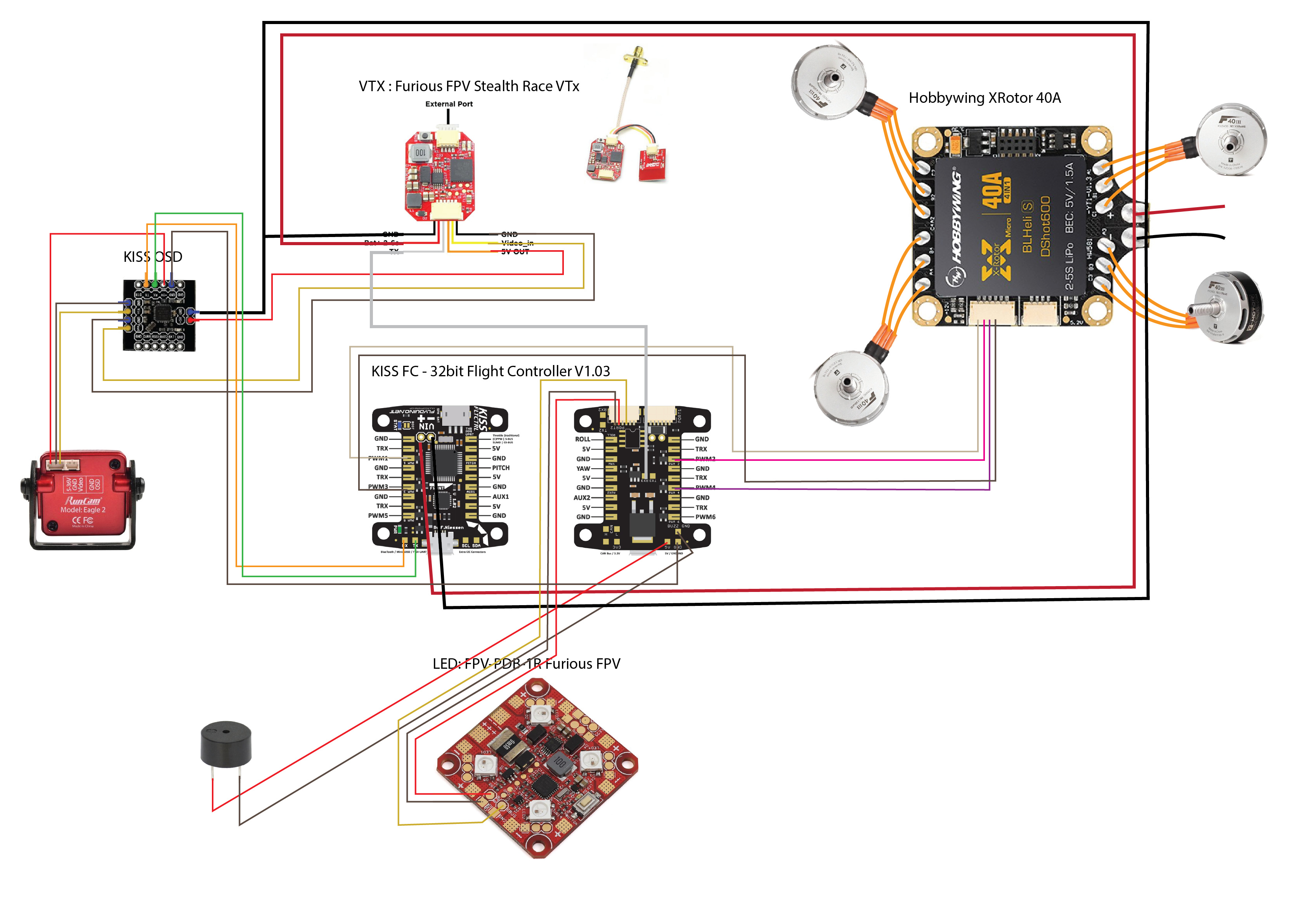

Could someone look at my circuit.
I uploaded an Image of the circuit

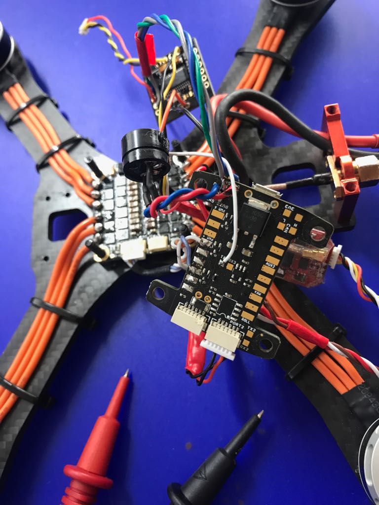

can you send in a photo of your wiring…
One thing that could have fried your board is if you got the power backwards.
do you have a voltmeter with continuity checker?

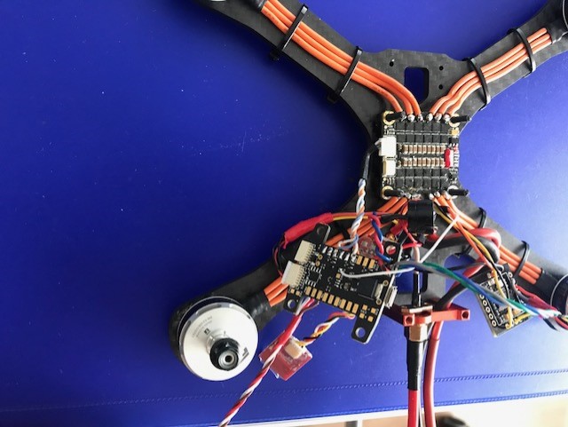

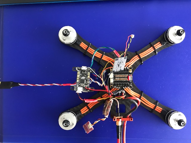

Here I send a photo of the wiring. (it should be the same as in the schema)
Before I plugged in the Power I checked, if the main power was reversed or if there is a solder point that shorted the board

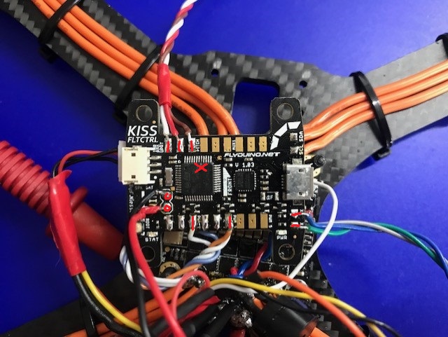

the red cross shows where the fire started.
I found the Issue. It was in relation with the LED Furios Board. The Main BAT Power was reversed. I think this was causing the short on the KISS FC.
well done finiding the fault.
Sorry it cost you a Kiss FC.
You can never check your build enough during build.
