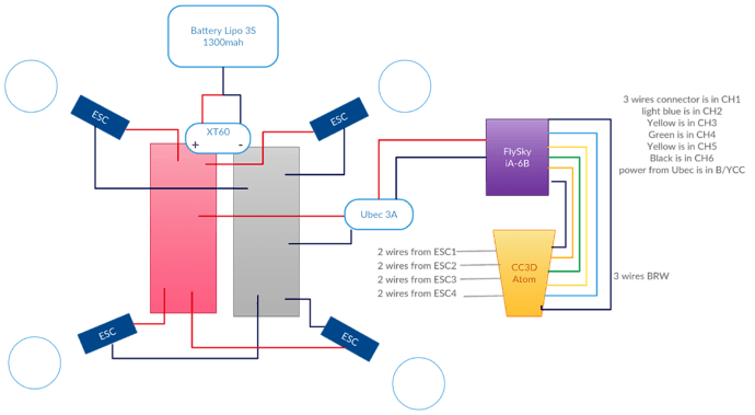

Could you maybe include a few pictures as its hard to understand exactly what is going on as I am not very familiar with that frame.
However it sounds like you have not connected your receiver correctly, as the receiver /main/flexi port on CC3D provides 5V out to power your receiver. I believe the top two pins are for power and ground respectively.

I apologise for the poor quality of the drawing but I’m not an engineer however it should reflect the wiring diagram I have so far on the Tarot 280H. It is the one with the swinging canopy from Tarot… same as the 250 but with longer arms to put 6 inch props.
Totally beginner with drone.

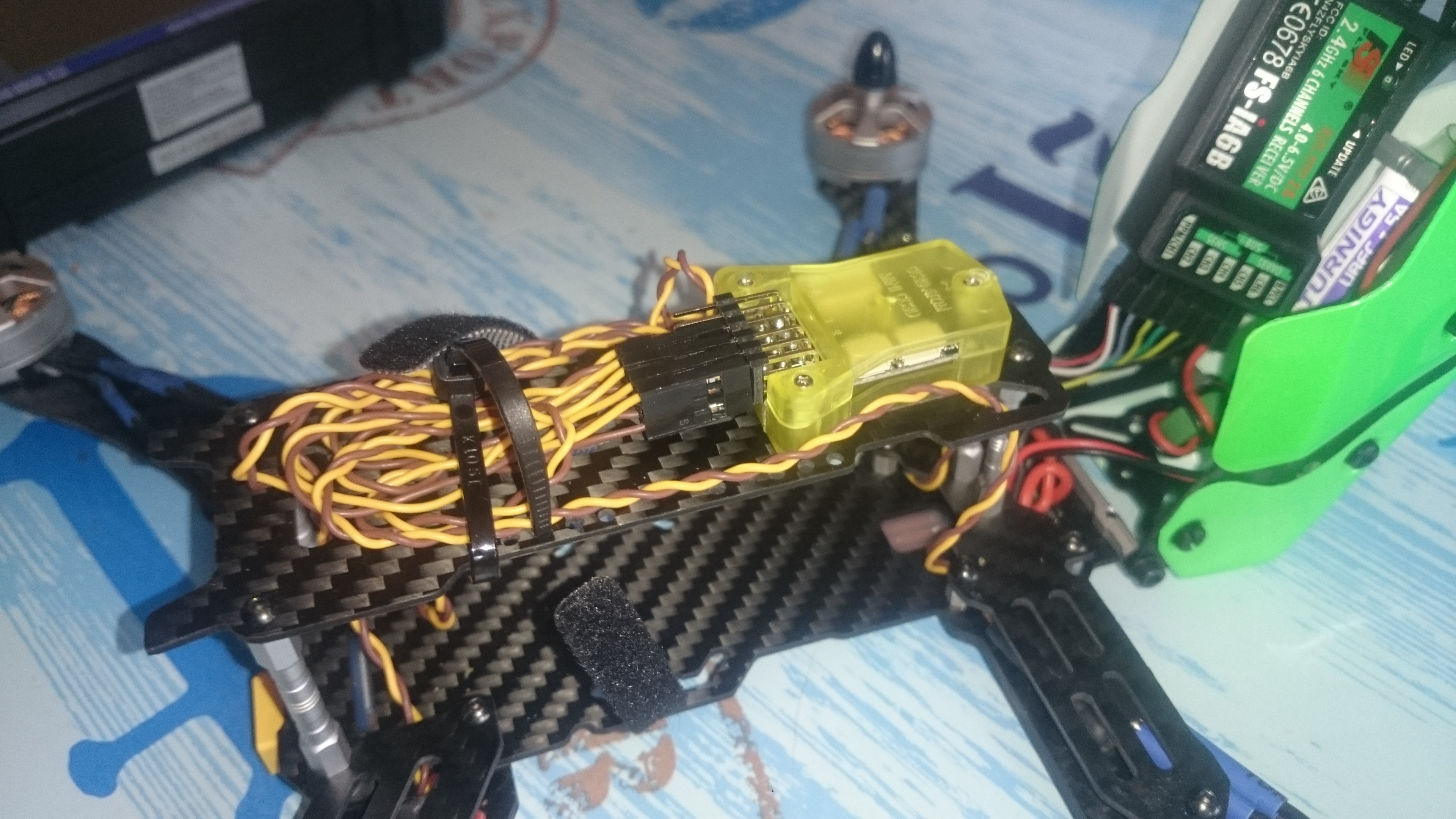

I have attached some pics I took for your review. One thing is I had soldered all the connections first to do all the calibration and setup wizard then when all was ok I desoldered everything to cut each wire to length and do a proper solder everywhere with some heatshrink so it is need and protected.

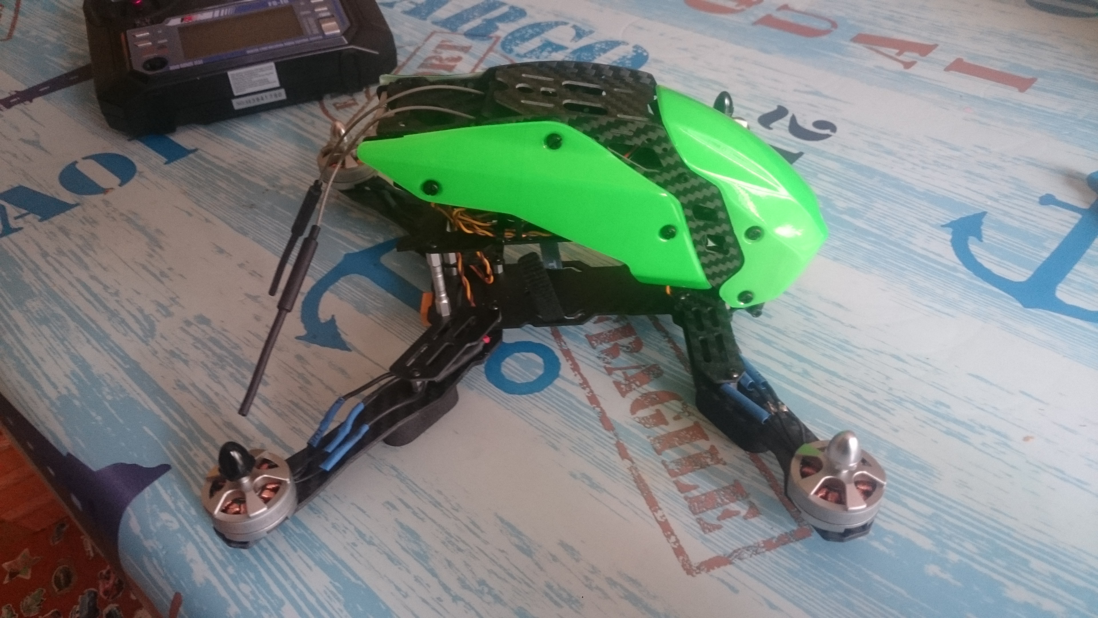

few pics of my quad below…
not all the heatshrink are set yet as I wanted to test each motor was working as intended and in spinning in the correct direction before setting them. The Rx is a bit big and I need to find it a place.

Looks good, and if you do have any questions just let me know and I will try and help as best I can :slight_smile:
