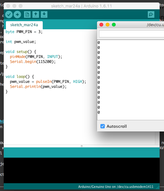

I was unable to get the servo output working so I connected Ch.1 to the Arduino to read the raw PWM output.
Here’s what that looks like:

Measured output:
PWM value = 0.

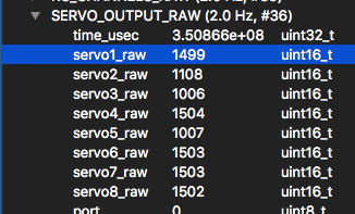

Additional input on the issue, note that the expected outputs are consistent with the RC input:
However, the observed PWM output is 0 for all servo channels.
