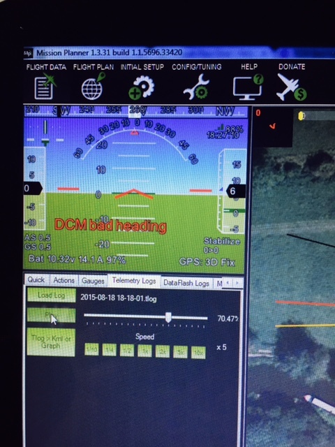

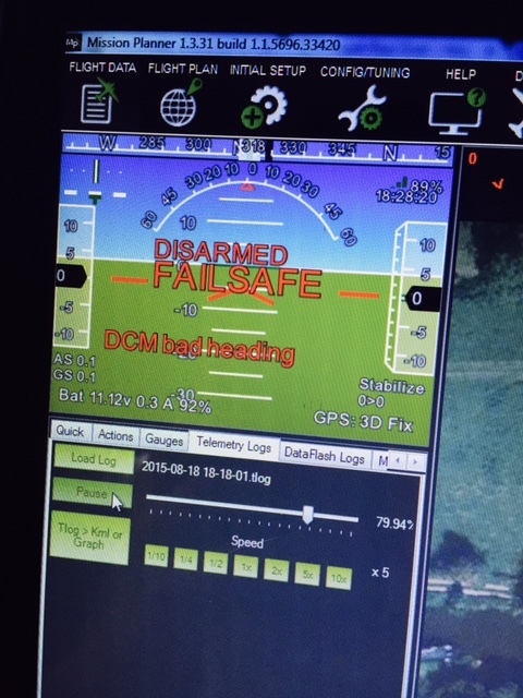

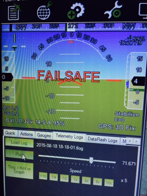

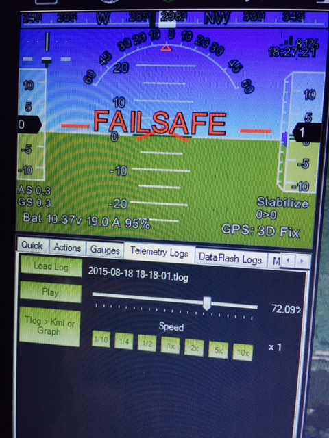

Few errors that I have taken screenshots of during the flight. I replayed the logs and took some screenshots:
FAILSAFE (not sure why)
DCM Bad Headings
I read something about DCM being about the compass heading not matching the actual heading. The pole is quite far away from the drone, so interference should be ok?

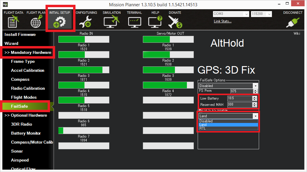

Also I got the message ‘low battery’ You can see from the screenshot that the battery is at 10.32v. Where can I configure what the lowest voltage should be? Its a 3S lipo 3300 MaH. I was under the impression it would be ok to run the battery to 3.2 or 3.4 volts per cell. 9.6 or 10.2 volts equiv. I guess that is about right, 3.4v is the safest per cell for a discharge voltage.
Took it out for another flight. Looks like GPS is working nicely. No fail safe message this time as voltages stayed higher.
Only question remains about DCM bad heading message really.
Happy to hear you had a flight, and I think the compass/GPS issues where doe to calibration close to a metal object, in your video it would look like it was taken on a canal boat which could explain the issue.
Can you possibly download the .log from the pixhawk (not the telemetry log) and attach it here and I can have a quick look to see if there is any obvious issue for the failsafe.
Otherwise it could be due to the battery failsafe, in which case you can set the voltage in the failsafe options screen:

This is something that I think you should definitely fix before having another flight as that check is there to prevent flyaways. Since you completed a compass calibration my other suggestion would be to check the orientation of the module in the settings as this error generally occurs when the heading from GPS is different by over 60 degrees to what the pixhawk calculates.
