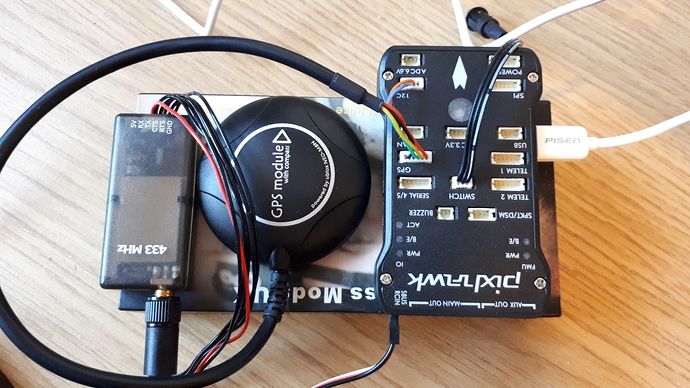

Could you double check that you have connected your external GPS/compass module.correcrly. and during calibration are you ensuring you are away from any sources of magnetic noise. Like large metal objects or power lines?
Lastly can you share a few photos of how your pixhawk/GPS are mounted and also the GPS/compass settings in mission planner. If it’s not interference causing the issue maybe it’s orientation is wrong?

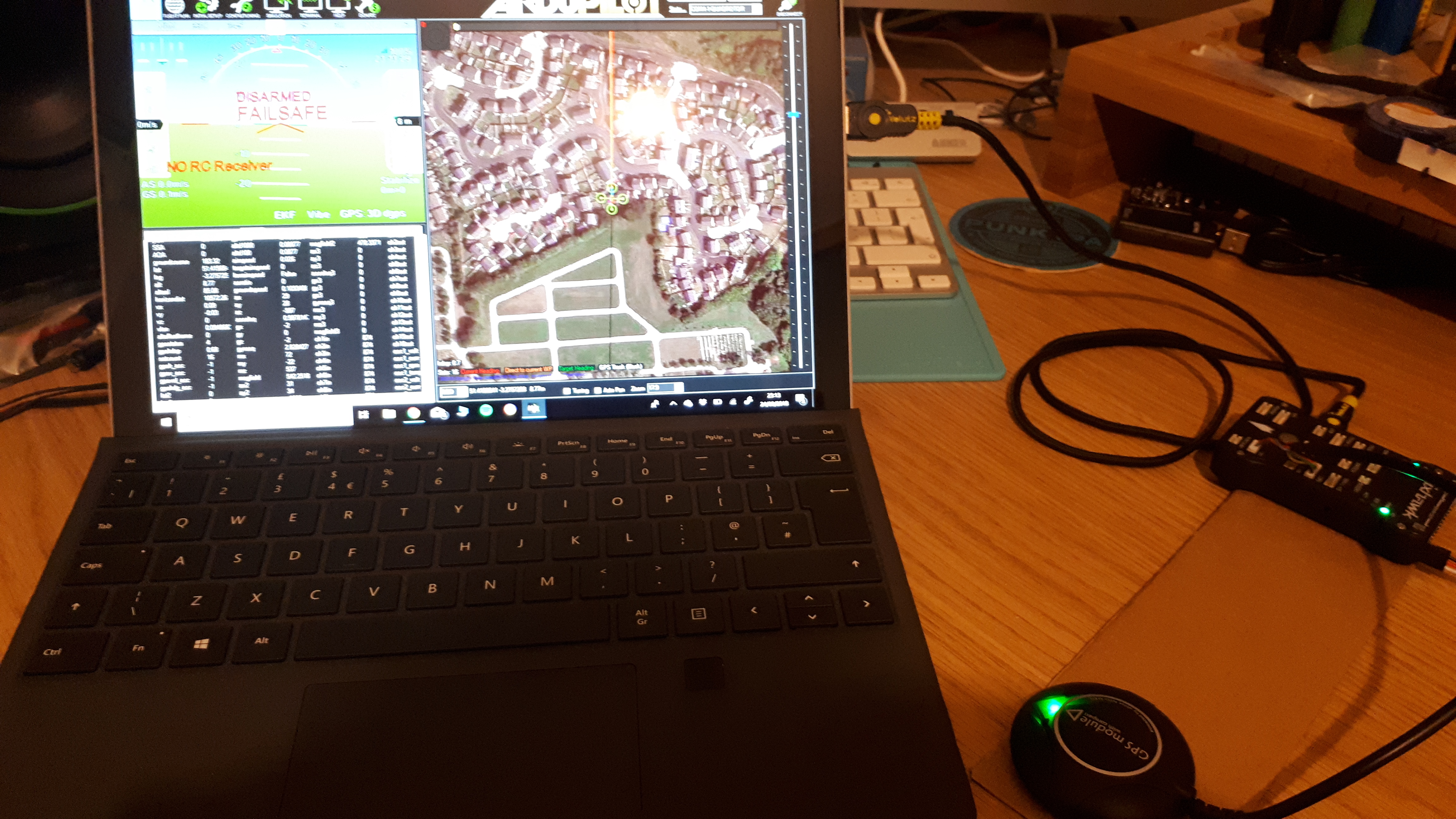

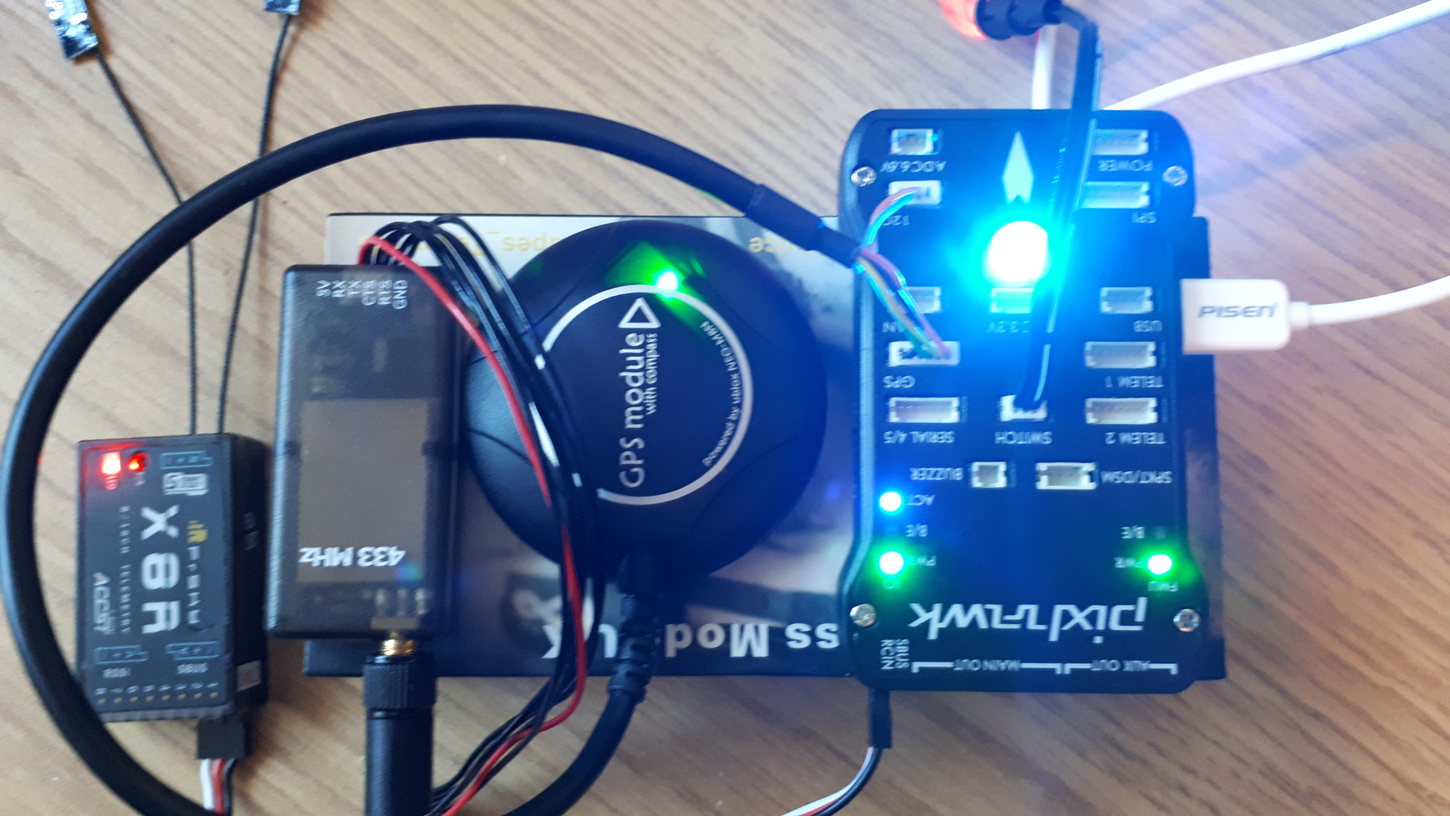

Connections are correct I think. Its mounted on a box for setup and callibration Here are a few photos and screenshots to help. I find it strange that the callboration page doesn’t have the default options for pixhawk (as I’ve seen in other tutorials and videos). This doesn’t seem to pick up the external gps even with different options.
The screenshots also show the strange mag calibration behaviour on the live calibration wizard. GPS is working correctly.

Happy to see you made some progress, but you could probably get the external one working if you mount it at least 5cm (ideally over 15cm) away from any other device as the compass is extremely sensitive.

Alex you are a legend! Got It working last night by moving the external GPS away from the board. Never imagined they were this sensitive. Managed to get the latest version of ardupilot installed through mission planner too :+1: Looking forward to flying this now. Thanks for your help!
