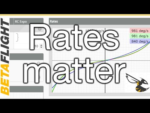

If you are a beginner as you sad, the standard PID’s should be okay…
To the Rates:
Just play a bit with them in a Simulator.
After a few hours of testing you should get a hang on it…
There are also some good Tutorials out there:
