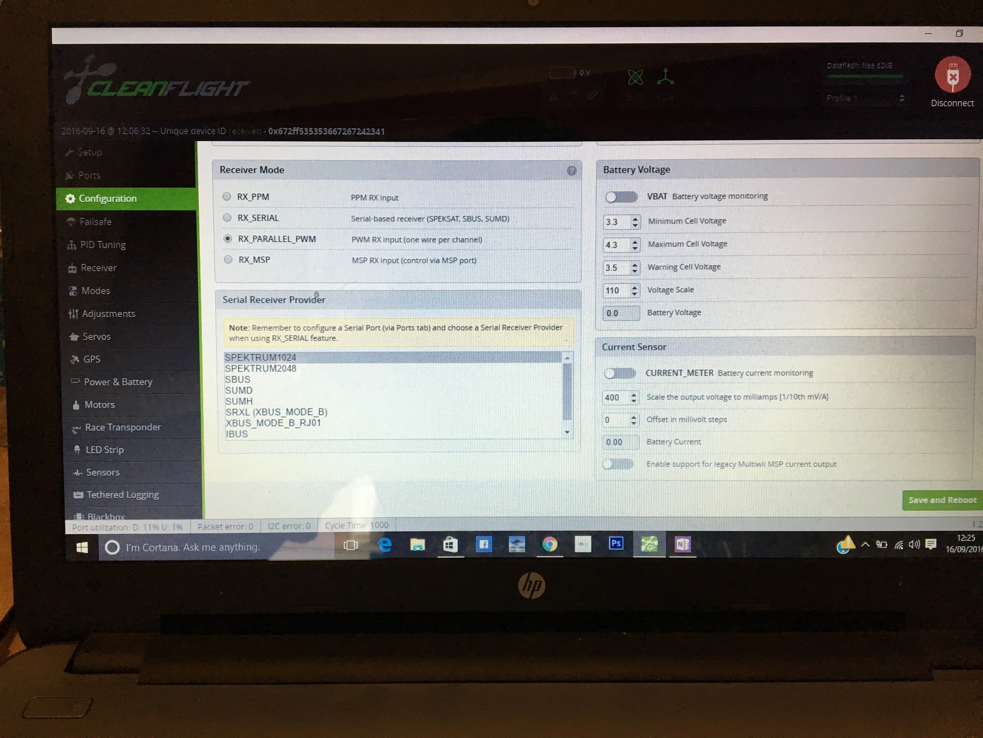

go to the “configuration tab” in the section, “receiver mode” check “rx_parallel_pwm” then click save at the bottom of the page
