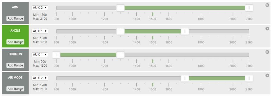

Best is to set one of your spare switch channels to be to arm/disarm your quad as I setup in the guide -
#12
Thanks for the quick response! And I was able to get the motors armed after after reverting back to default settings and just keeping my yaw rotated 90 and tilt -10. Just holding my throttle down and to the right, motors engage…
I will experiment later today with seeing if I can successfully get setting an arm switch to work. I guess I get lost with aux 1 and 2 settings on the modes. I have configured the controller so aux 1 and 2 are switch c and d, it just seemed any directions I had the switches flipped, or flipped them to, it made no difference.

Looks like if no mode is selected, then it defaults to “air/acro” mode. And after some more time playing around in cleanflight and with the transmitter, it seems like my 6th channel just isn’t connected to the FC???
Channel 5 works fine with all 4 switches (tested all 4 to make sure it wasn’t a wiring issue with Swc A,B, or D on transmitter) even could confirm to see the slider/indicator change in cleanflight. However when setting any of the other switches to channel 6, nothing seems to happen (in cleanflight or on the quad) like it does with channel 5.
Even was able to get Swc C on ch. 5 to work as an arm switch, I didn’t keep it set this way and reverted back to Swc C for flight modes, but more was just testing for my own understanding on how the arm switch would end up working.
I’m guessing it’s safe to assume, without digging into the quad and confirming that Ch. 6 isn’t connected, and then actually getting it wired in, I’m either stuck with 1 flight mode (acro) and an arm switch… or I arm the motors with the throttle stick, and can switch between flight modes?

haha oh yeah, I press and held cancel. I was able to see on the receiver in the quad had not only the “bind” pins open but also the ch. 6 pins had nothing attached. Got the bottom board taken off and took a wild guess and matched the only other free plug floating around in the drone with a red, white, and black wire (to match the plug in the ch. 5 pins). After hooking that up to the ch. 6 pins on the receiver, and some tweaks to the “Mode” settings in cleanflight… we have an arm switch!!! :smiley:
Now in my transmitter, ch. 5 is SwC and ch. 6 is SwB, yet SwB shows up as Aux 3 when programming in cleanflight… not sure why but if anyone else out there has similar issues and it seems like everything is hooked up but still not working when programming Modes, check the “Receiver” tab and flip all the switches around… that’s how I noticed it was Aux 3 not Aux 2 for me.
