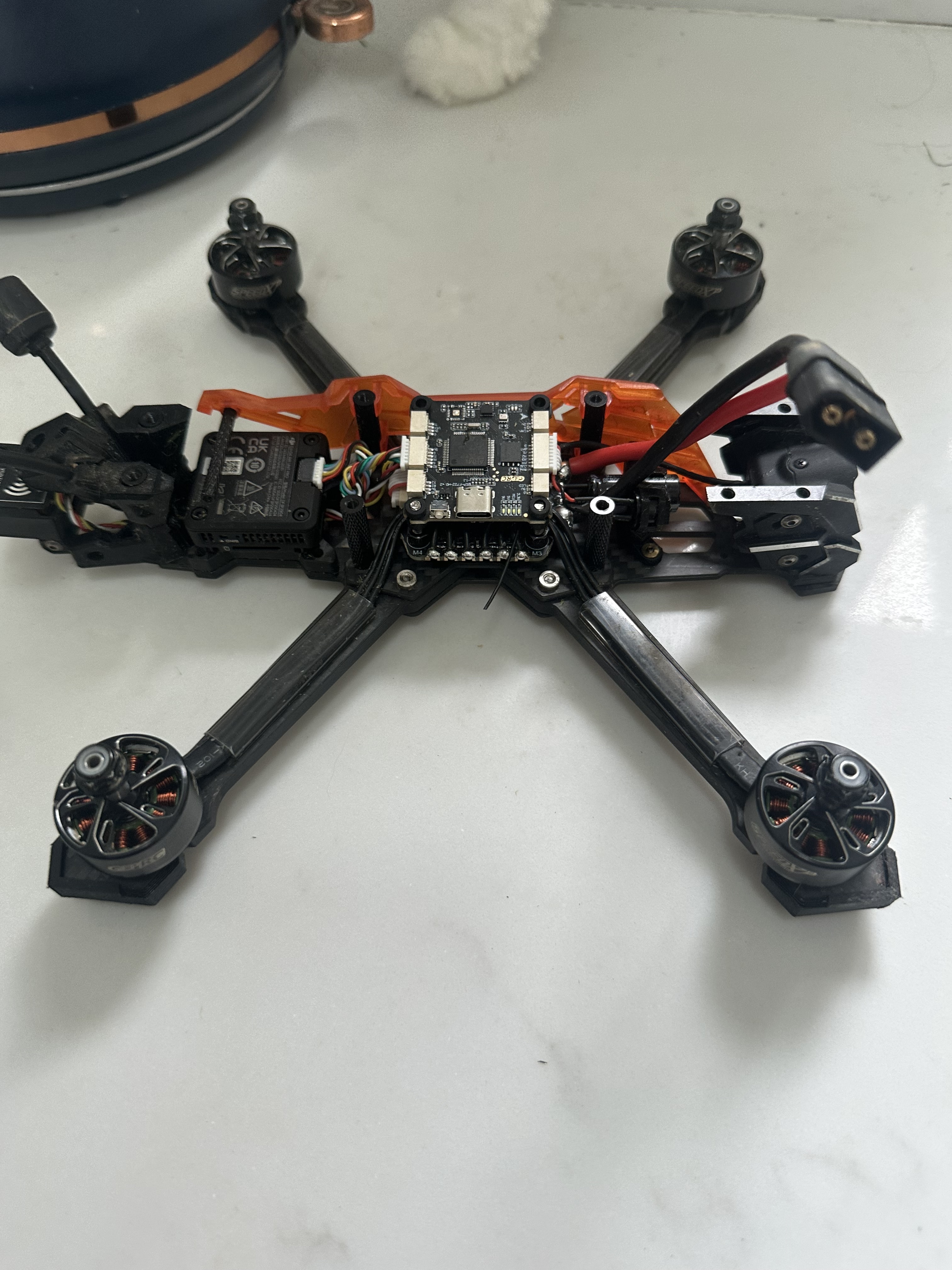

Had the drone a week or 2 used it and no problems went to use it the next day it made a beep but then went duh dum
I took of the cover and it looks like the flight controller is burnt
I’ve tried to boot load but it won’t connect to computer tried to force boot load but computer won’t recognise devices

You’re right, a burnt MCU (the main chip on the flight controller) is a tricky one. We’re currently waiting to hear back from GepRC on a similar case. Typically, they see issues like this when there’s been an external short – sometimes from things like damp long grass, debris, or an unfortunate crash. This can make warranty claims a bit more complex, as they often view it as external damage.

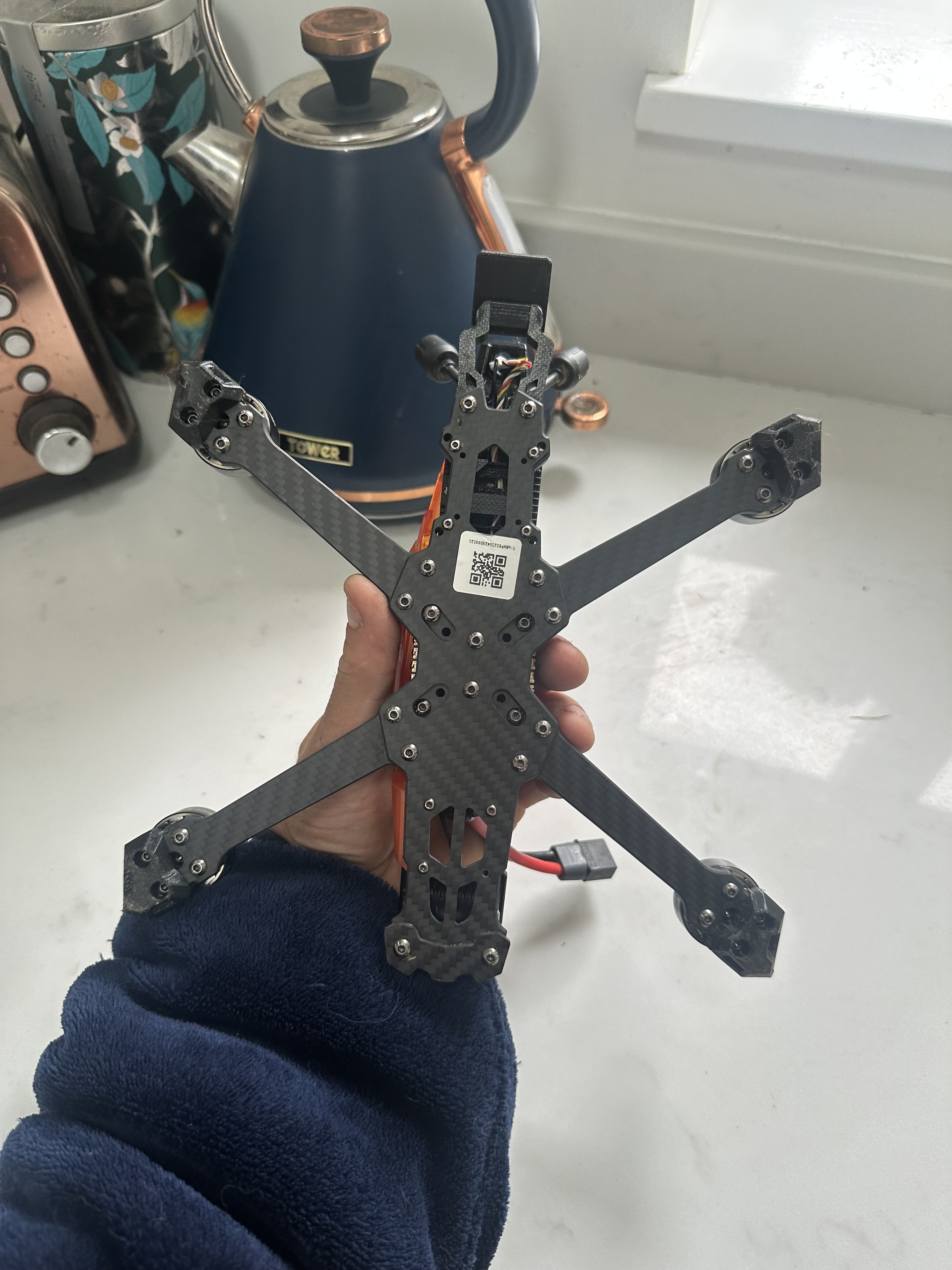

To help us make the strongest possible case for you with GepRC, could you snap a few more photos showing the overall condition of the quad? This will give us a good picture to share with them and show how the drone has been looked after.
As soon as we have those, we’ll get in touch with GepRC directly and see what they advise. We’ll keep you in the loop!

Hiya is there any update please I sent the picture on Friday but now I’m unsure they got sent I sent them to the email and uploaded in here but it said the system flagged it and was going to get review that was the last message I got I’ve tried again to upload ![]()
Thanks for the photos, I am not sure why they were flagged, but we have send this off to GepRC now so we should ahve an update from them shortly about the next steps, we have asked if they can authorise a replacement FC under warranty, but they may ask to check a few more things to establish the cause of the fault etc… I will keep you updated as soon as we hear back from them.

I’m very sorry to report that despite several follow-ups and appeals for leniency, GEPRC has ultimately rejected the fault claim. Their technical team concluded that the damage appears consistent with exposure to moisture – likely due to flying or landing in wet grass – which they consider outside of warranty coverage.

Unfortunately, they have decided not to approve a replacement. Their technical team explained that the main processor on the board (the MCU) very rarely fails spontaneously. Based on their assessment, they concluded that the damage points to an external short circuit, which isn’t covered by their manufacturing warranty.
