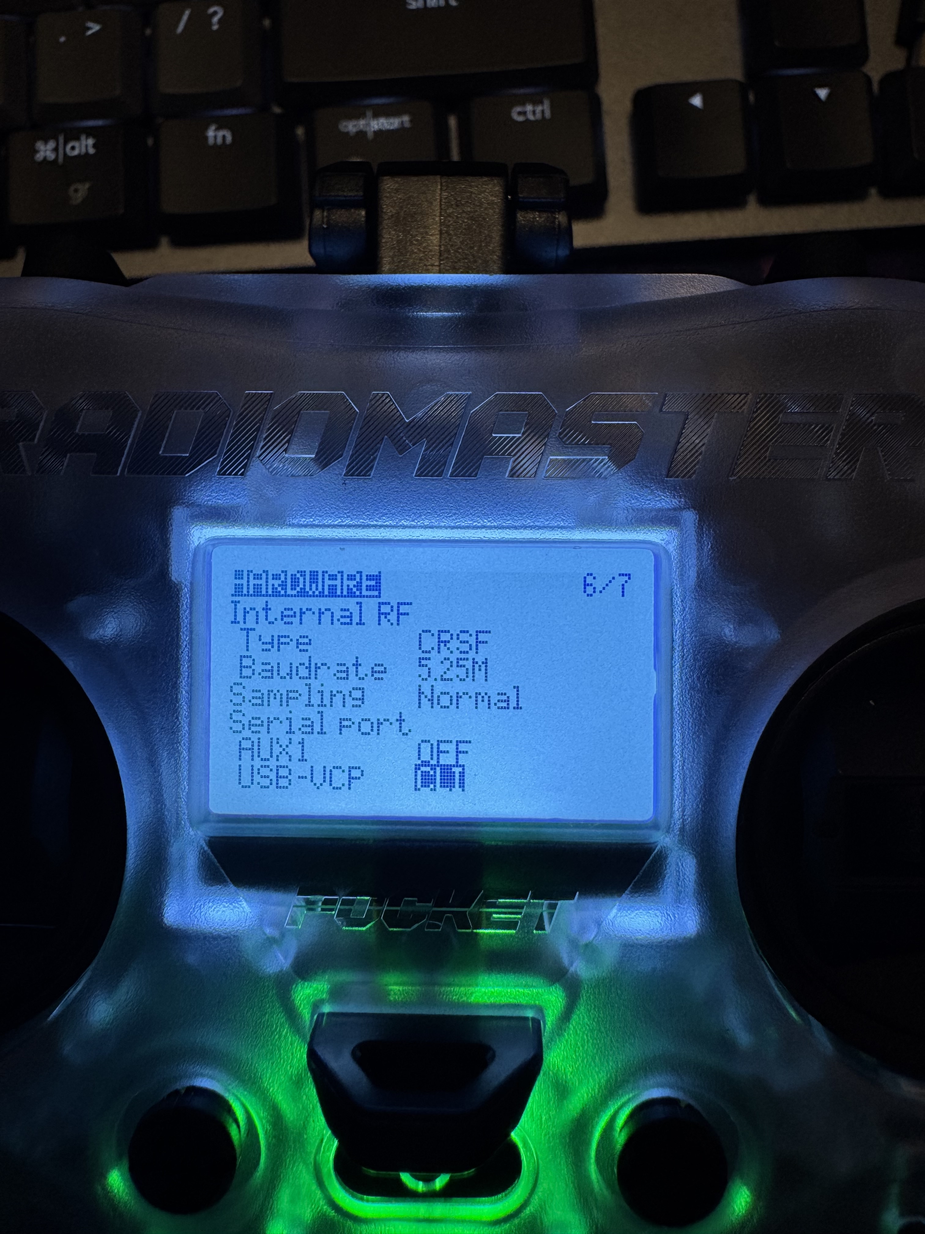

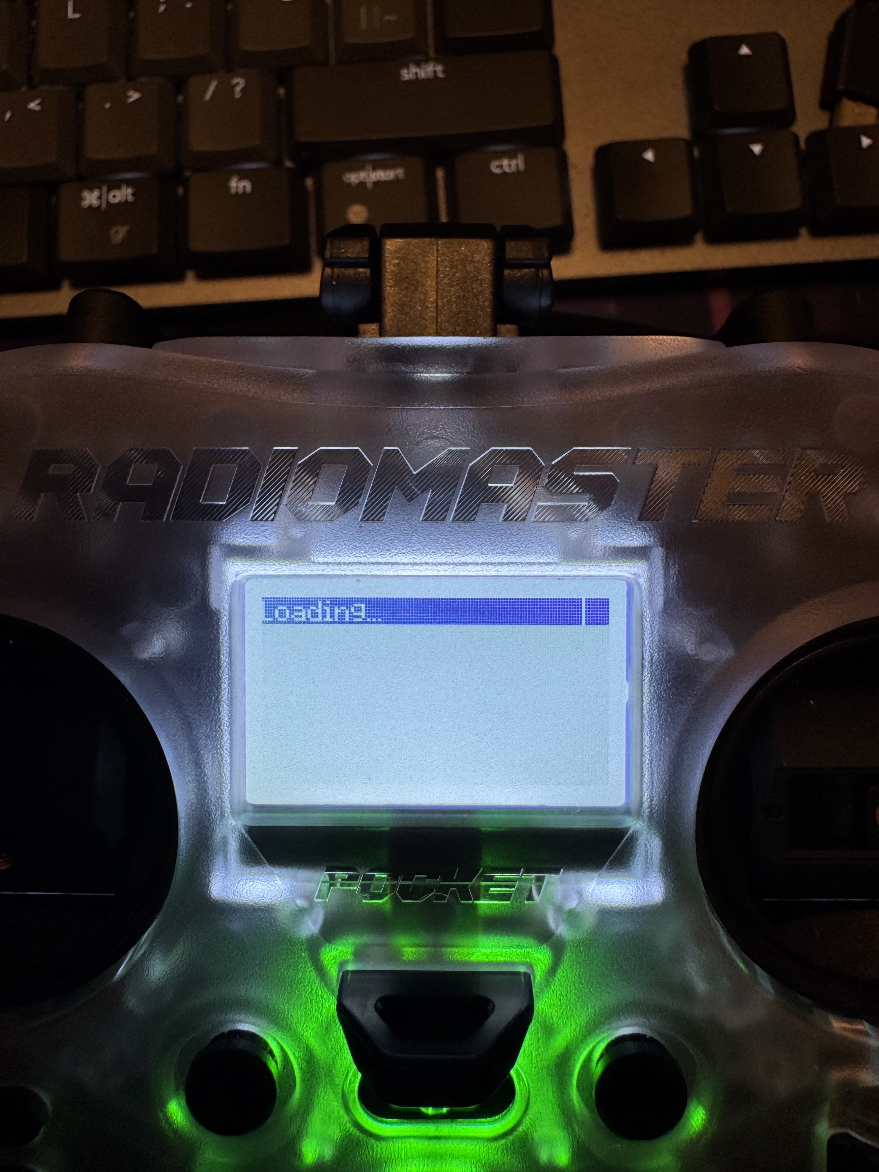

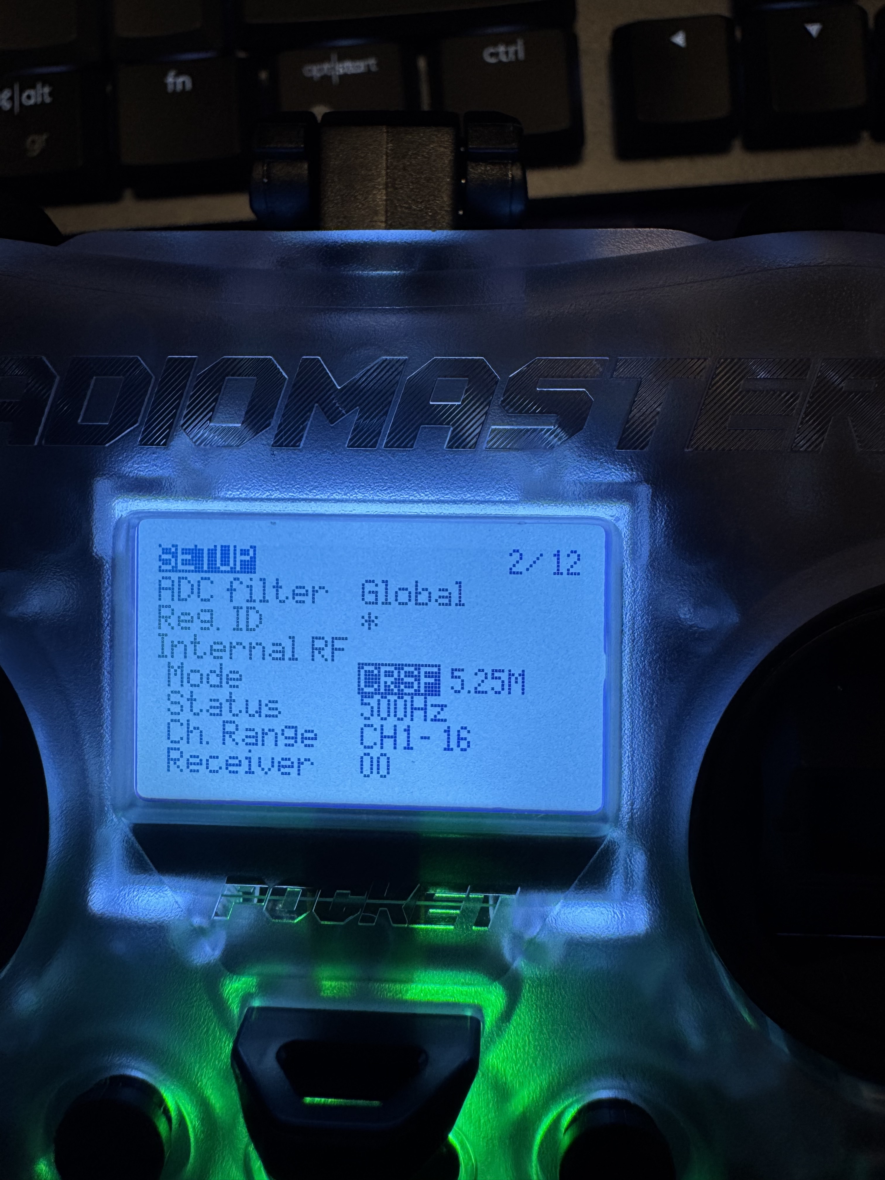

Radio was initially set to Multi and not CRSF, even after putting into CRSF. Loading ELRS just sits in a “loading” loop, very frustrating for a brand new radio.
I’ve checked to see if it’s updated, it is, I’ve changed inter RF to the correct setting that it should have been from factory, and it still isn’t working.
Hi good day,
That would make sense, given you have selected the internal RF module, which is CC2500.
If you want to use ELRS on a CC2500 version radio you would then need to use an external module.
