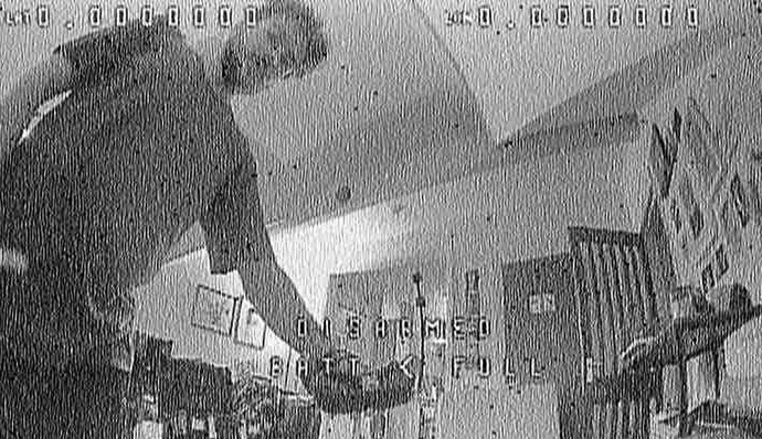

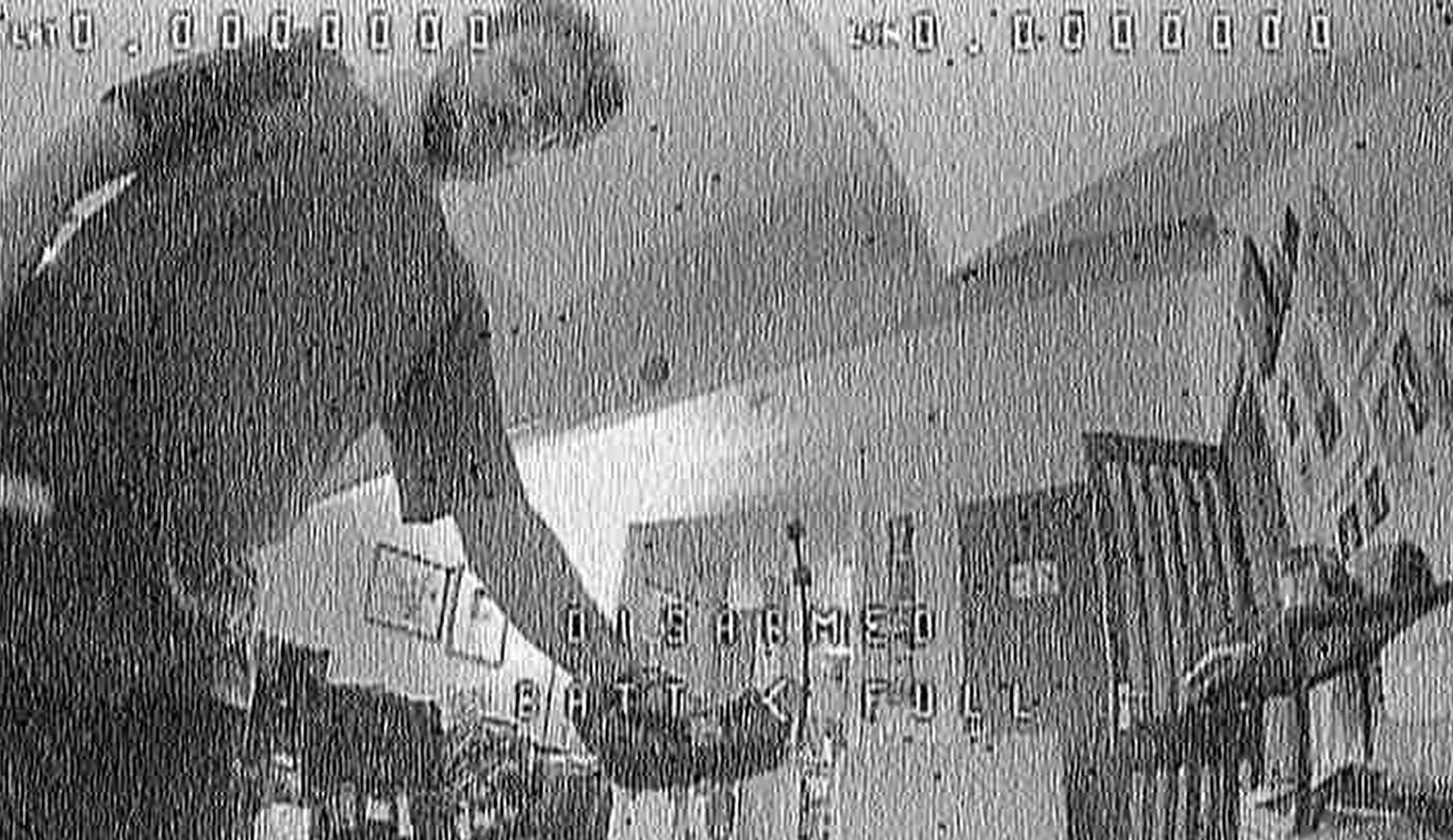

Please see the following videos which demonstrate the information you have asked for.

Then I prop up the camera and show the signal quality at 1m, 5m, 8m and ~20m on the TBS VTX, demonstrating that even at eight metres it has broken up to the point of being unusable.
Then I plug the same pigtail and antenna into a drone with a working VTX. In the bottom right of the DVR you can see that it is on the same power and channel. No issues can be seen in the DVR. This demonstrates that the pigtail and antenna work fine, and there is not interference where we are testing. The issue must be the TBS VTX.

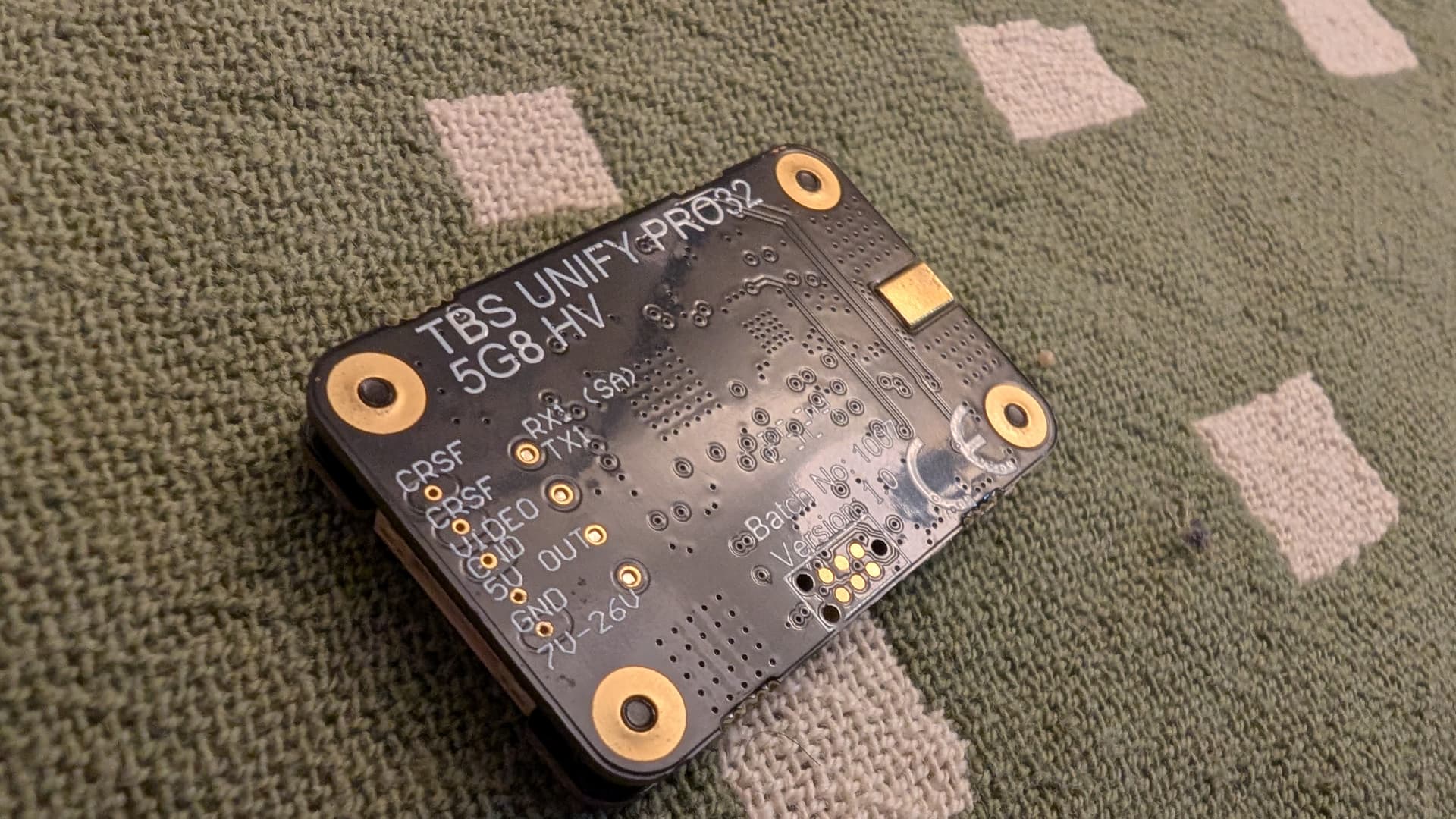

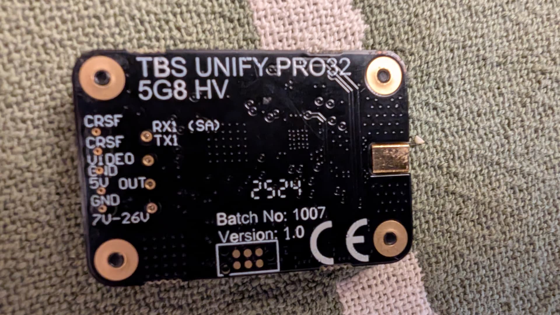

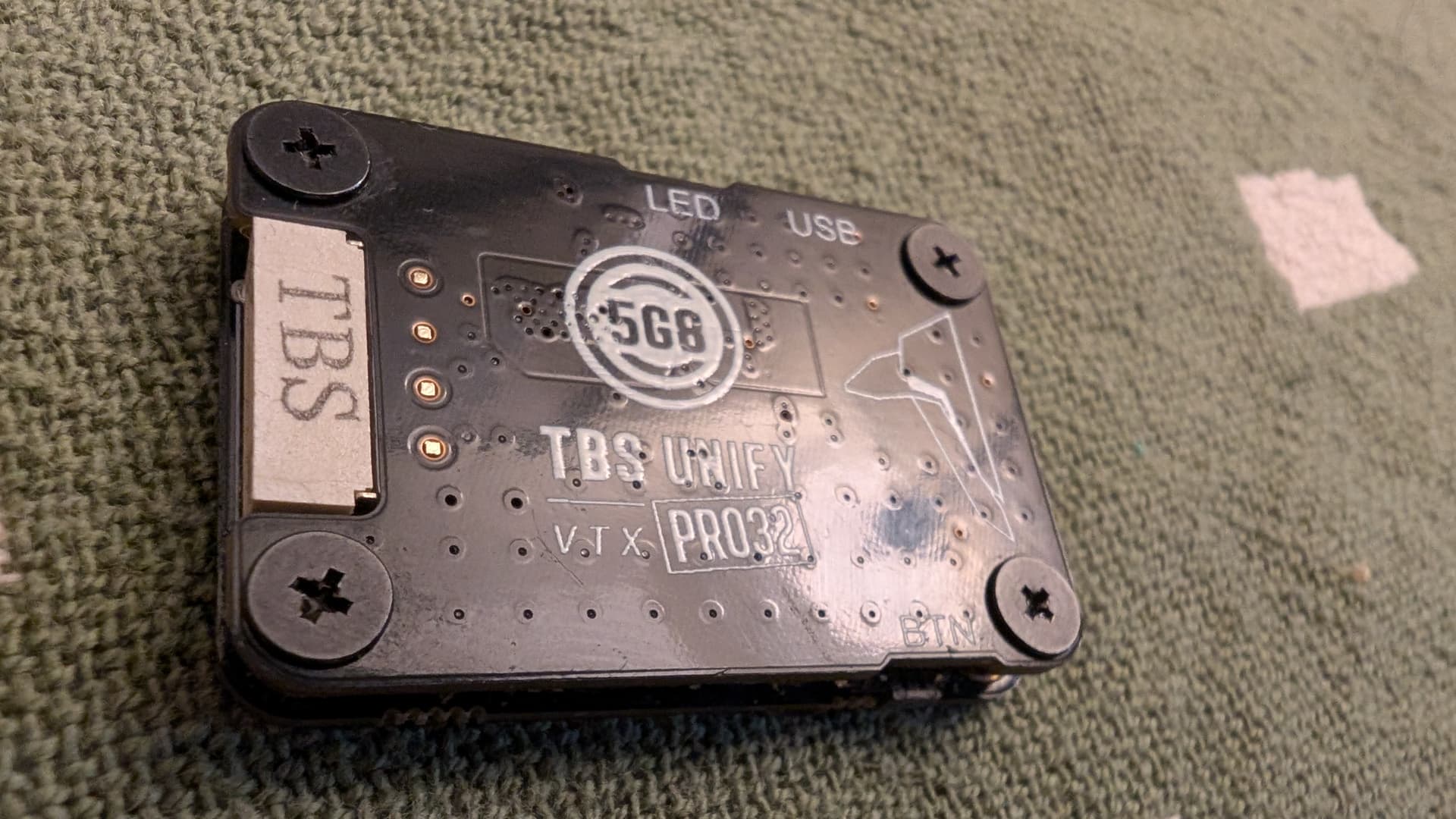

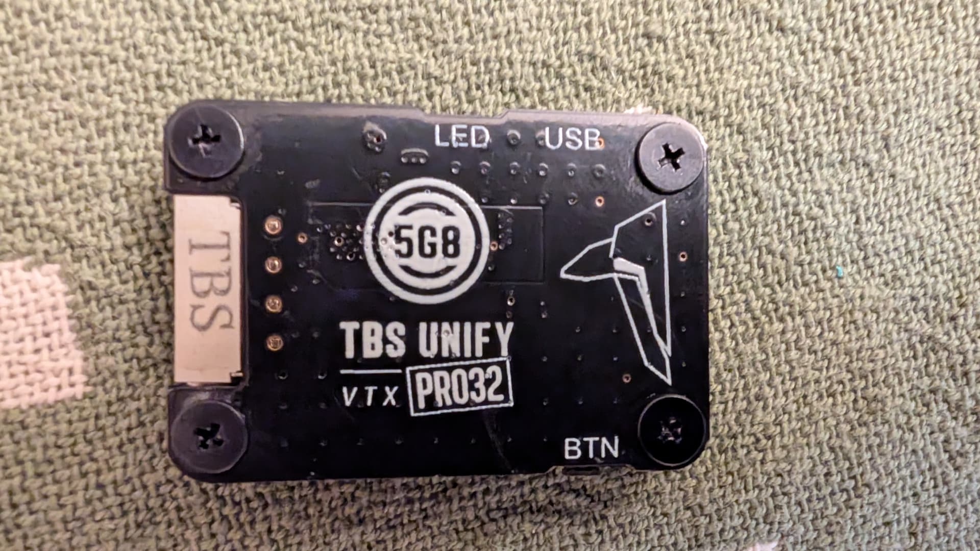

  • Could you please provide high-resolution photos of the top and bottom of the unit for inspection?
Once we have these details, we’ll be happy to pass them on to the supplier for further review.

When I got the drone stuck in the tree, the pigtail broke. That was the end of flying for that day after we spent an hour retrieving it, so I didn’t notice the issue until the next time I took it out, maybe a week or so later.
I am reasonably confident that the crash itself was not what broke the VTX however, since I still had a perfect picture in my googles while the drone was in the tree.
I’ve added the photos.

I have had the final word from TBS, and unfortunately, they have firmly rejected the claim.
While we pushed regarding the “safe to power without antenna” feature, their engineers have determined that the failure was caused by mechanical stress from crash damage.
To clarify why they are so sure: electronics like VTXs are incredibly sensitive to physical shock. When a drone hits the ground, the G-force transfers through the frame to the VTX. This causes the circuit board (PCB) to flex slightly.
  • The Damage: This flexing can create microscopic cracks in solder joints or brittle internal components (like ceramic capacitors).
  • The Result: That tiny physical crack creates an electrical short. The “fried” component you see is the result of that short circuit happening after the impact.
So, while it looks like an electrical failure, the root cause was the physical impact knocking things out of alignment internally.
