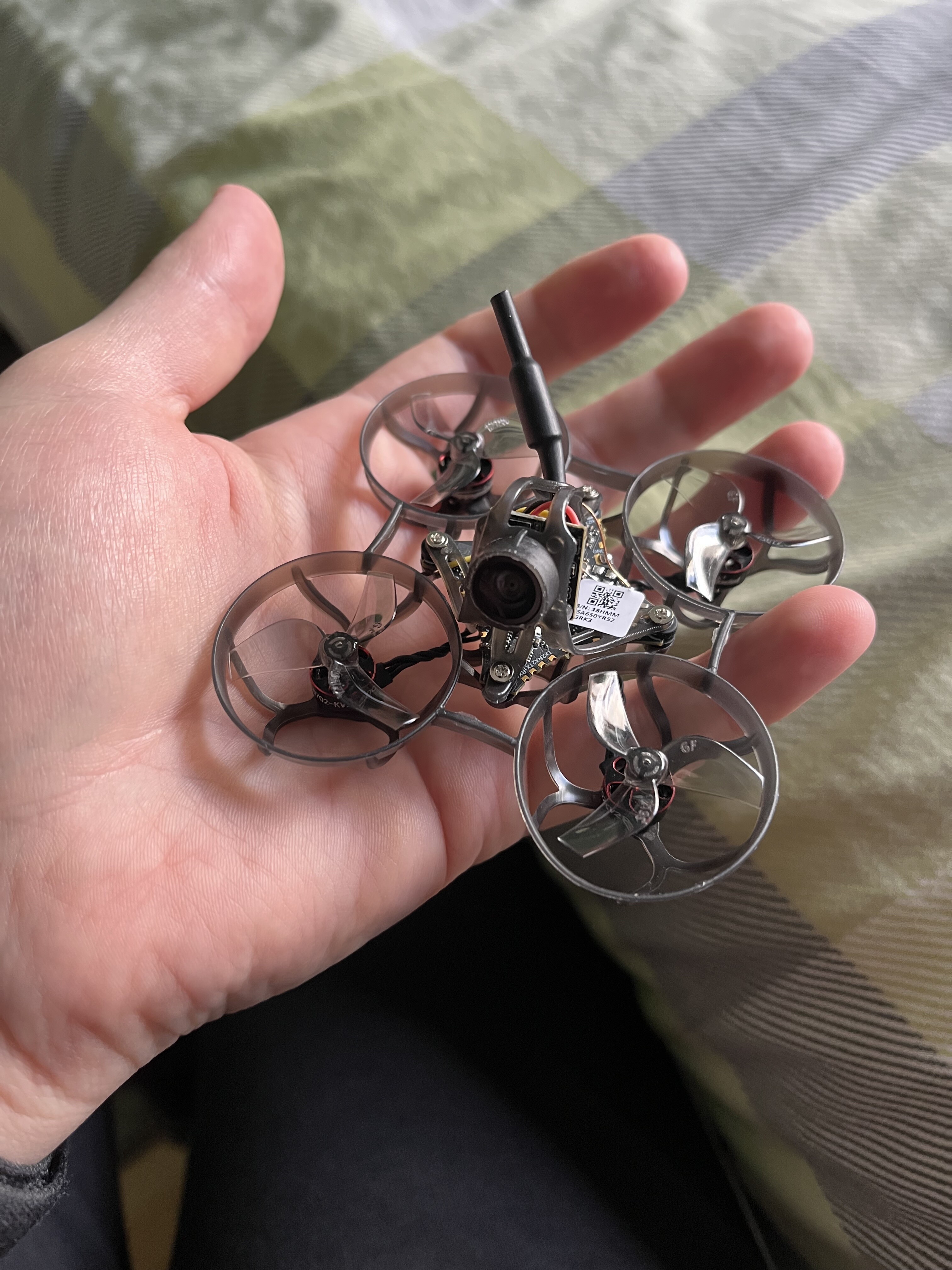

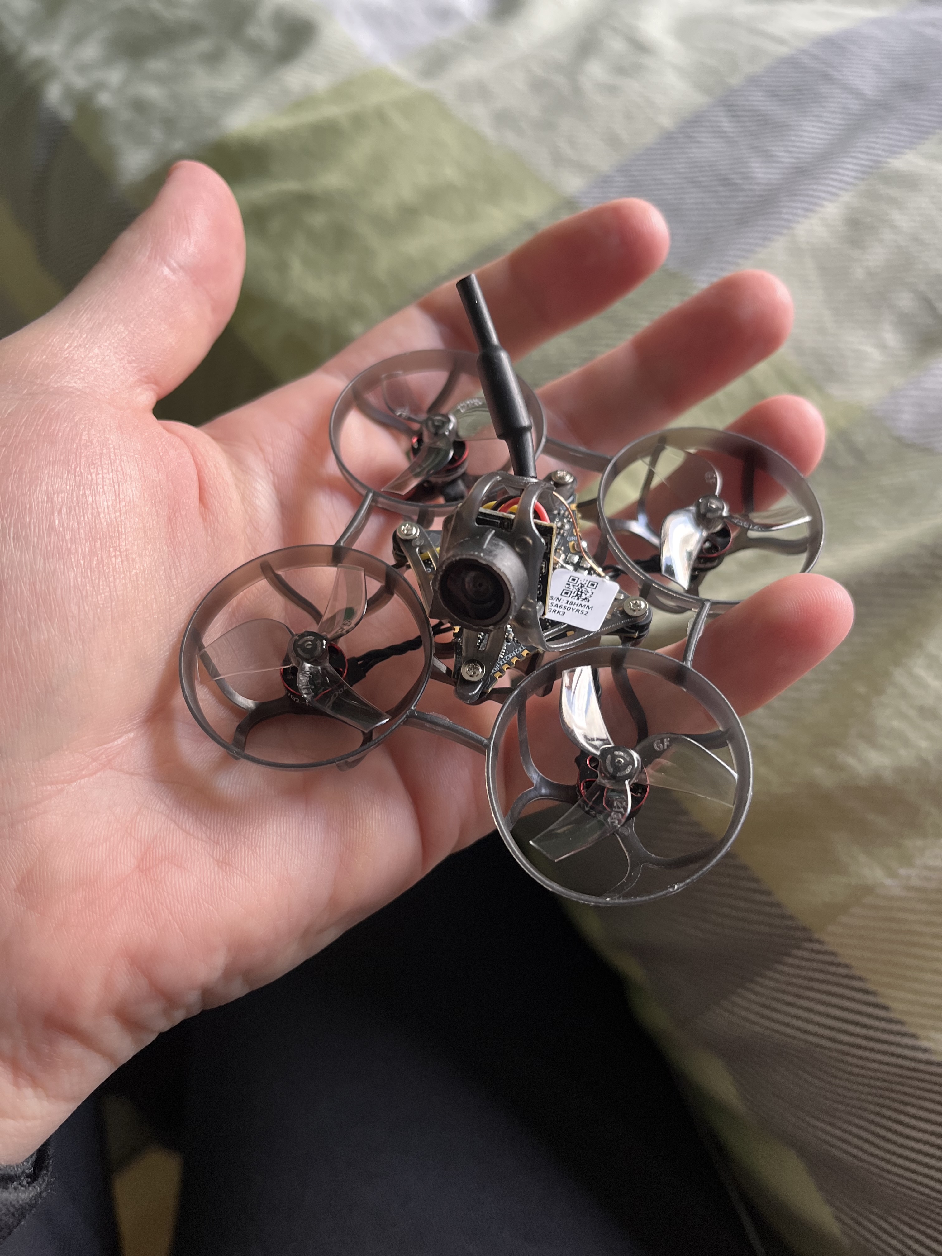

My VTX appears to be faulty.
After several failed attempts to get it to change from E2 to R8 (100mW) in Betaflight, it finally changed to R8. However, the image is washed out looking, and when I move my head to the side the image becomes snowy, and if I move even a short distance away, it becomes entirely static, not showing either the OSD or any image.
I am using Skyzone 04O Pro goggles, which are tuned to the same R8 band/frequency. I was monitoring the temperature of the AIO through the goggles, and had a fan pointed directly at it no more than 10cm away.
– Changed from R8 back to E2, and ensured my goggles were on the same Band/Frequency. This made no difference.
– Checked the camera and camera wiring for damage. There was none that I could identify.
– Checked that the antenna was securely fastened. It was.
– Replaced it with another (new) 5cm whip antenna to check if it was a U.FL connection or torn antenna issue. This exchange made no difference.
– Took the canopy off and removed the sticker to conduct a visual check of the AIO, which showed no damage to it that I could identify.
