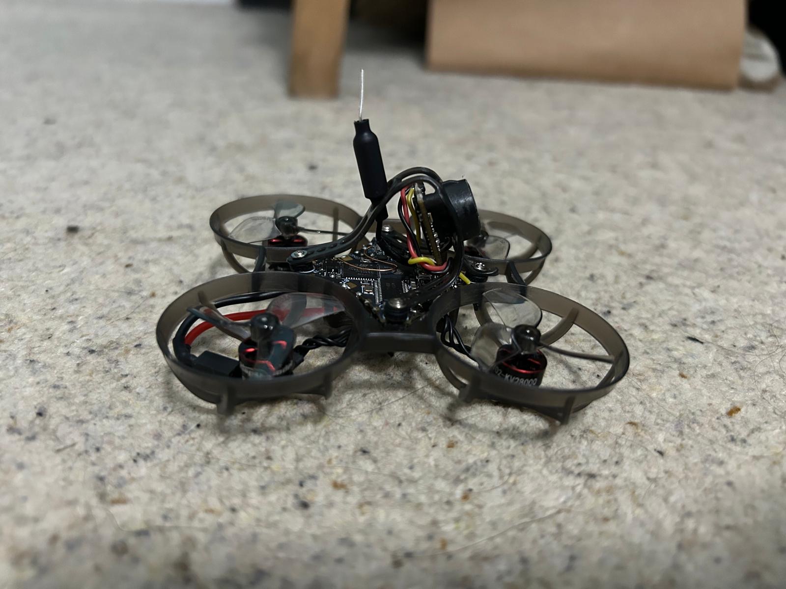

The drone initially flew well, but then, from one flight to another after a battery change, started flying uncontrollably backwards and to the left. After some troubleshooting, the drone now flies uncontrollably upwards.
No settings had changed, so we checked the propellors and motors (which were fine) and re-flashed the firmware (including ESC) in case something had corrupted. After restoring settings and trouble shooting a load of issues (e.g. no video caused by telemetry switched off, motors not arming because PID frequency was different from Gyro frequency?) it now flies uncontrollably straight upwards (this appears to be called ‘runaway throttle?’) but we are unable to prevent this from happening. This drone appears to just be broken or misconfigured in some way we cannot determine despite spending hours trying to return it to how it flew before it suddenly stopped working properly.

It sounds like a physical issue to me, but it could be a number of possibilities.
Is the frame cracked of broken anywhere, of is the FC mounting broken or is the FC loose on the frame?
Do the motors get hot very quickly?
Would you be able to send me a short video demonstrating the issue, so I can try identify the issue?

Thank you for getting back to me - the frame is not cracked of broken anywhere, The FC mounting isn’t broken or loose on the frame. The motors do heat up but I don’t know if that is the issue. Essentially at this point we would really like to return this drone for a refund. Is that possible? - I included a video in my original enquiry but am attaching it again.
