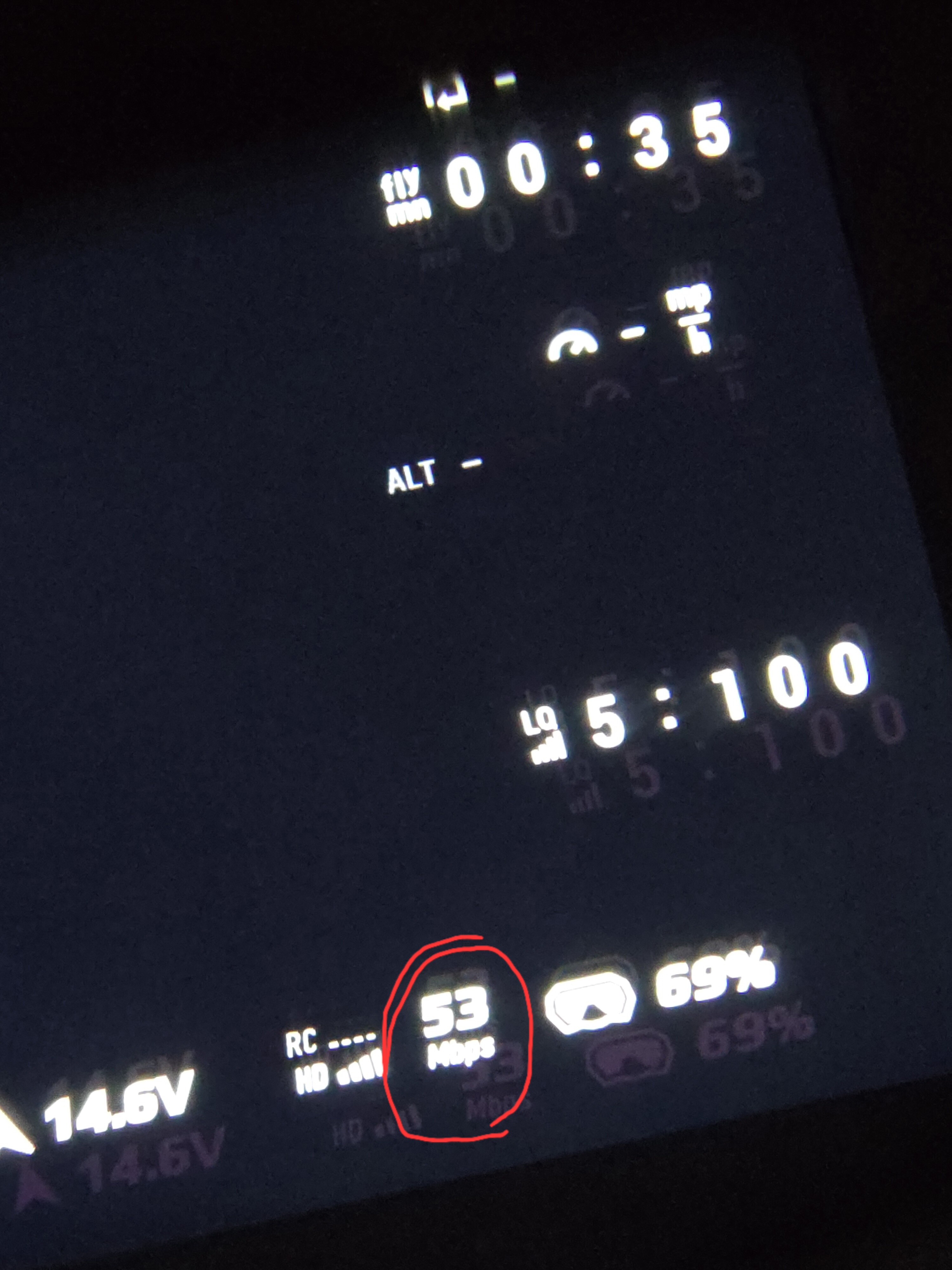

I have installed as per instructions video however i am not reaching full 60mbps bit rate through the goggles. It’s a dji o4 vtx which normally hits 60mbps stable with stock antennas
not much i could do, i took it apart checked connections, all fine

To help us pin this down quickly, could you reply with:
  • A quick photo showing how they’re mounted on your Goggles N3
  • The bitrate you’re seeing (and roughly what distance/altitude when it drops)
  • Goggles firmware version
  • Whether this was tested in an open field or around trees/buildings
