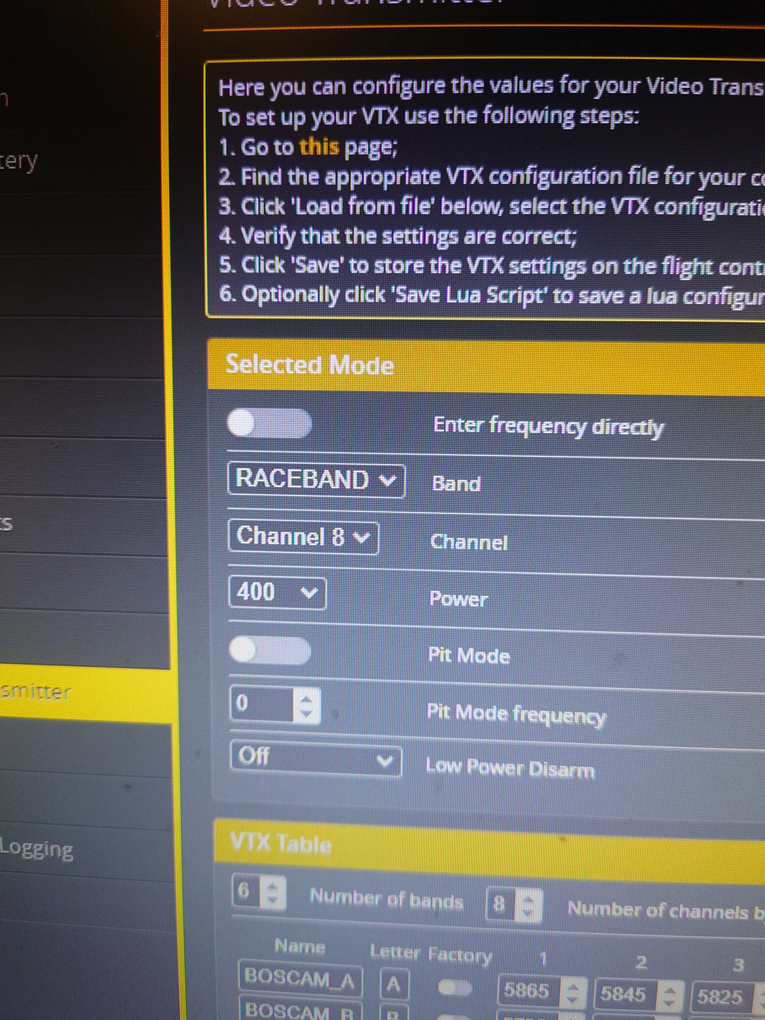

My draknight was flying fine yesterday, I only flew 2 packs and I didn’t have any crashes or anything yesterday. I go to fly it today and the video isnt trasmitting to the goggles. I searched the channels with my goggles and found it is outputting on A2/3 instead of R8 which is what I usually use. The range is terrible on A2/3 but it is the only channel I am getting video to. I have tried resetting the drone in betaflight and installing a new antenna but the issue is still the same. i have reset the drone and used the cli dump file to try and get it back to factory settings, even though the only things I configured was the rates and osd when I first got it. I have only flown it for about 10 packs and it’s only started doing this today. It’s had a few small crashes into grass on the garden but it has always carried on flying fine. Just wondering if you have ever seen anything like this? Is my aio dead?
I have tried resetting the drone in betaflight, and then flashing with a CLI dump, then I installed a new antenna but the issue is still the same.
I have been sent the vtx table from HGLRC and I have flashed that with betaflight and t he issue is still the same.

Hi everyone, I’ve been having the exact same issues as described by kirkgamble in the very beginning when I first got the quad it seemed to be the output channel and frequency to match my Osd after a few flights vtx set at 400mw through betaflight cli and making sure through Osd check the power manually but would only stay there for the current flight or until disarmed the it would revert to 25mw and yes with low power disarm =off double checked through the cli, I would have to reset to 400 on osd every time I changed packs or disarmed , I did contact hglrc support after pasting my original diff all vtx table multiple times with no luck, somtimes the osd would show ? for power I never changed the power vakues that came with the quad! well they sent me a diff all if the current draknight with a vtx table that had nothing in common with m origonal hears what they sent.

With this I was able to stay in 400mw or any other power that I wanted all the time it still doesn’t work with low power disarm ,until first arm none at I got 400 mw all the time i just leave it there as of yesterday I did nothing new to the software or the hardware ,I just changed out the frame and rails everything back together as it was go to fly my goggles are not picking up osd ,I scan in the goggles after the third time I get video on band 2 BOSCAM and i think channel 4and 400m w don’t know how that’s possible double checked in betaflight everything still set how I had it raceband 5 ch 1 400mw double checked cli to confirm ?? I’m baffled don’t know what to do at this point I don’t know how good it’s going to fly on that band we got a winter storm here and wasn’t able to fly, so I don’t know contact hglrc support? it took a week and a half to get a response. if anyone could make sense of this and knows what’s going on or what else to do please let me know thank you!
