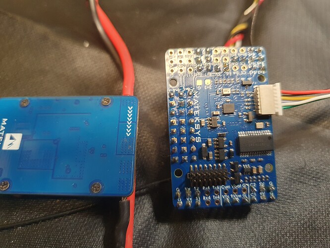

Over the past 3–4 weeks I have attempted to integrate a GPS module with my flight controller (FC) for a fixed wing UAV project. Despite extensive testing, configuration changes, and hardware verification, the FC has consistently failed to parse GPS data and has also refused to calibrate its internal compass. Multiple independent tests confirm the GPS modules are functional, the wiring is correct, and the UART port itself is operational. These findings strongly suggest the FC is defective or mis manufactured.

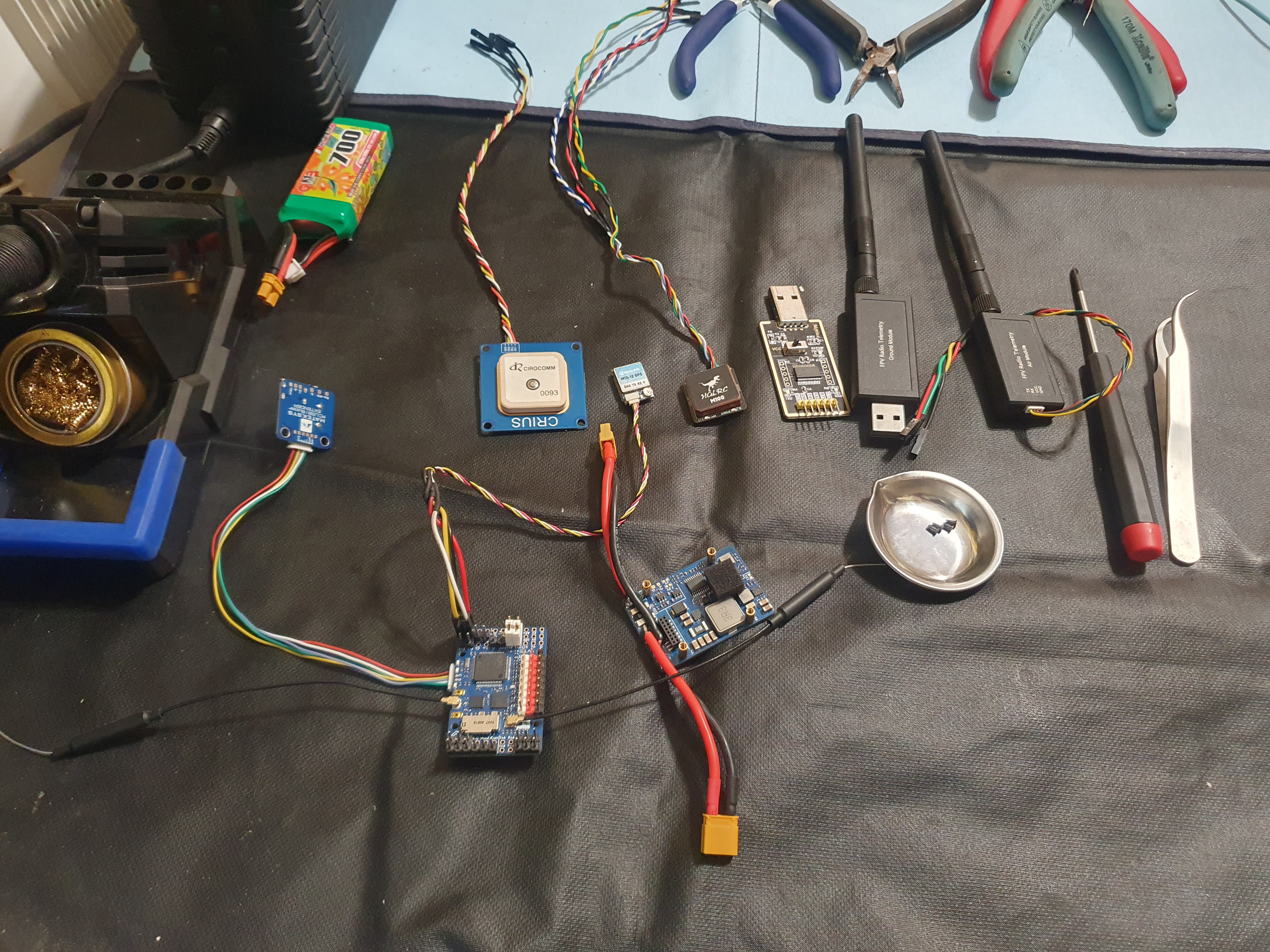

• Hardware used:
o Flight Controller (supplied unit, advertised as supporting GPS on Serial 3 / TX5 RX5).
o Multiple GPS modules (M10 12, M8N, others).
o 433 MHz telemetry module (used to verify UART functionality).
• Software tools:
o Mission Planner (ArduPilot).
o u center (Ublox GPS configuration).

A. GPS Module Verification
• Connected GPS modules to PC via USB TTL.
• Used u center to confirm satellites, baud rate (38400), and UBX protocol output.
• Verified modules powered correctly (LEDs active, ~5 V supply).
• Conclusion: GPS modules are functional.

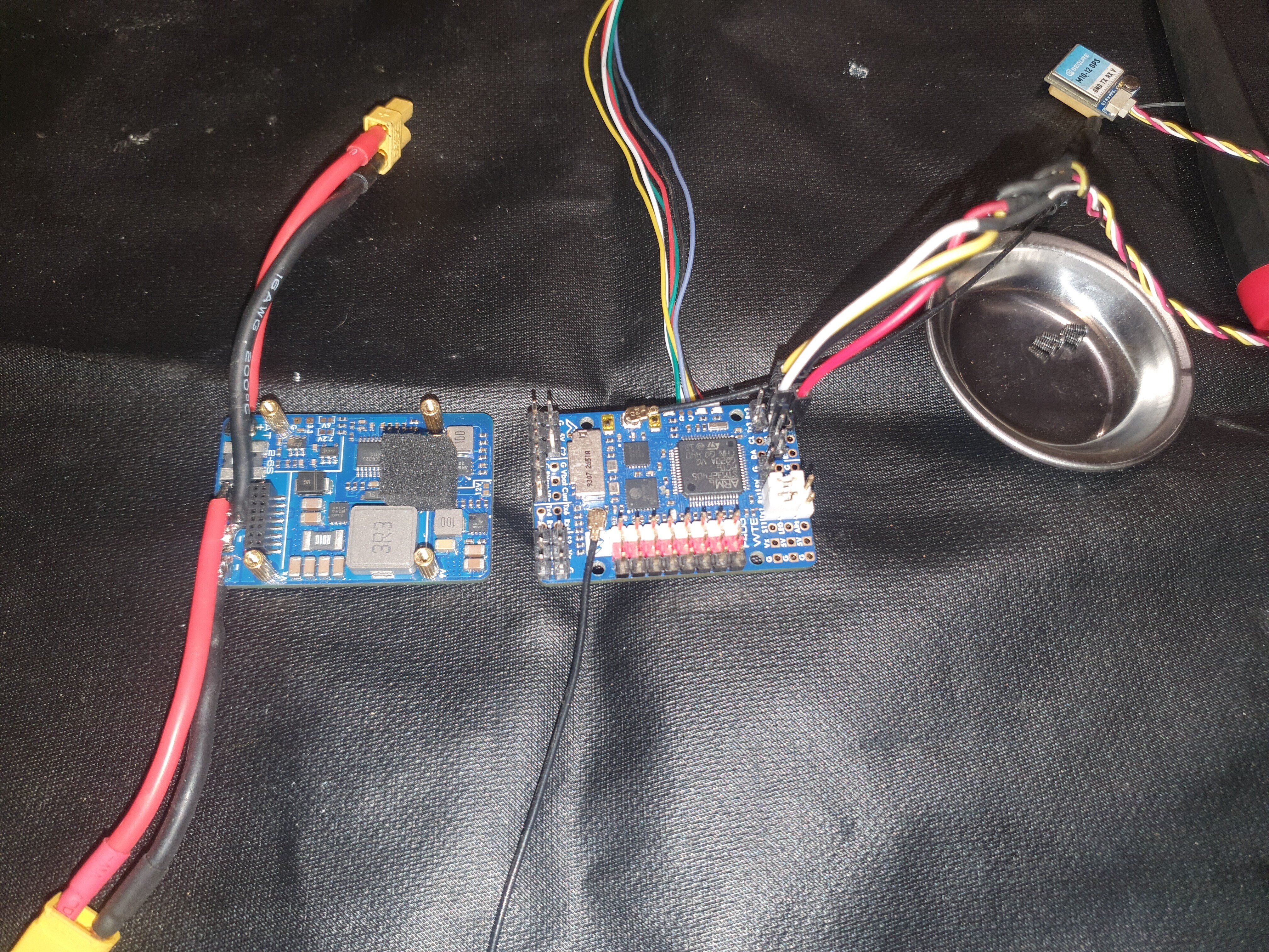

• Wired GPS to FC Serial 3 (TX5 RX5) as per datasheet.
• Configured parameters:
o SERIAL3_PROTOCOL = 5 (GPS).
o SERIAL3_BAUD = 38.
o GPS_TYPE = 1 (Ublox).
• Observed Mission Planner messages: “EKF waiting for GPS data” with no “GPS: 0.”
• Performed loopback test (TX→RX short) → confirmed UART echoes correctly.
• Connected telemetry module to TX5 RX5 → telemetry works, proving port hardware is functional.
• Conclusion: UART hardware is good, but GPS data not parsed.

    • Multiple GPS modules tested and confirmed working independently.
    • UART port proven functional with telemetry module and loopback test.
    • Correct wiring (TX↔RX, GND common, VCC ~4.8 V).
    • Correct parameters applied and saved in Mission Planner.

Hi there,
Thank you so much for your incredibly detailed report on the Matek F405-WTE ELRS Wing Flight Controller from Order #4165. We really appreciate the time you’ve invested in troubleshooting this—it’s clear you’ve covered all the bases, and that makes our job much easier.
After digging into the specs and your setup, I’ve got some good news and a few suggestions. First off, the internal compass issue isn’t a fault: this flight controller doesn’t have a built-in compass (magnetometer). It only has an IMU for gyro and accel, plus a barometer. So the calibration failure is expected behavior. For compass functionality, you’ll need an external module connected via I2C.
On the GPS side, your wiring and tests sound spot-on, and since the UART works with telemetry, it’s likely a config tweak rather than a defect. The board supports GPS on Serial 3 (TX5/RX5), but UART5 doesn’t have DMA, which can cause parsing hiccups with Ublox modules. Here’s what I’d recommend trying next:
