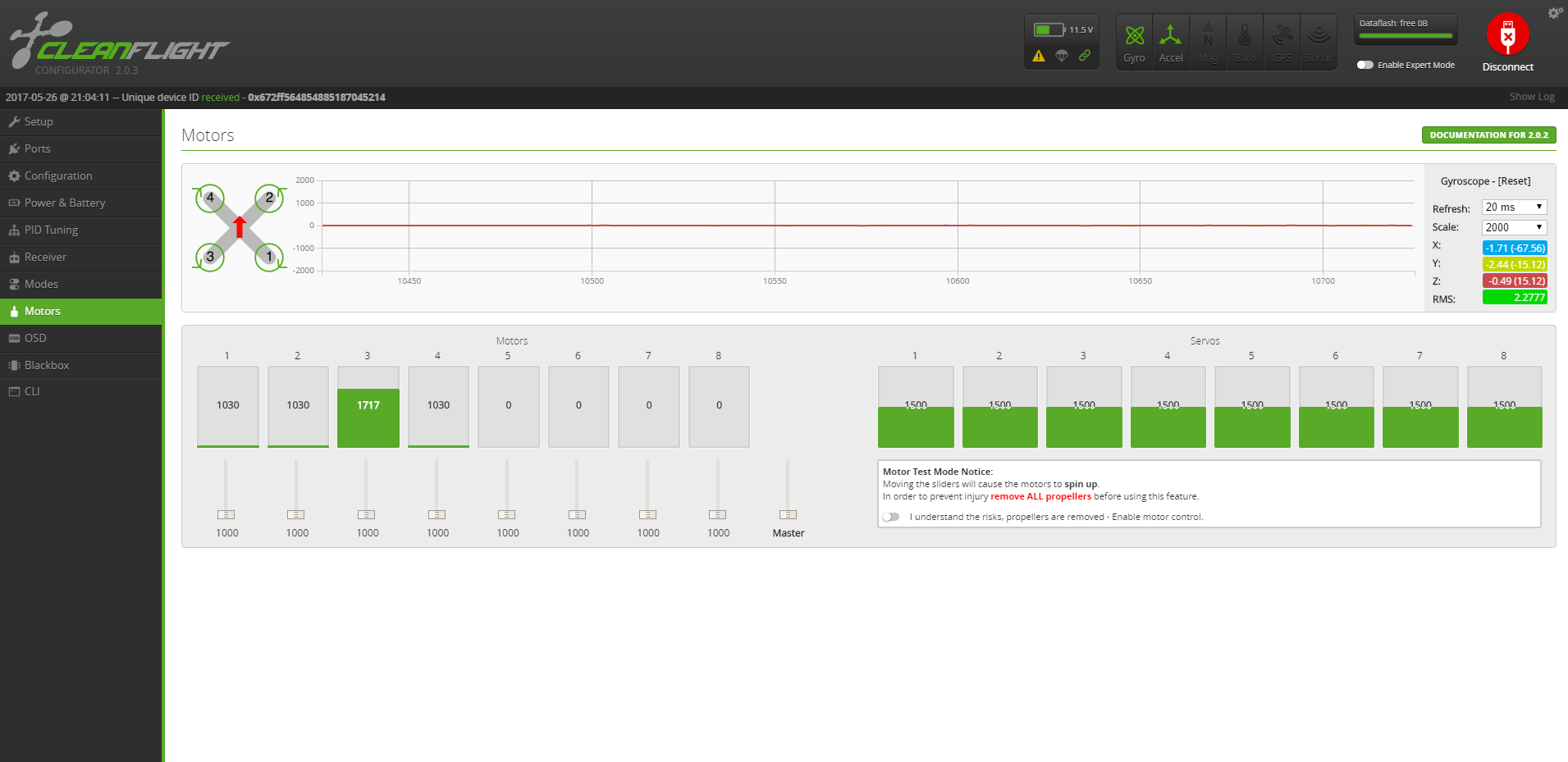

I’m having some problems with one of my motors - it’s spinning faster than all others.
This is what I get in CleanFlight
If I use the handle from CF to test the motors, then everything works great - all motors are at the same level.
But if I use my transmitter - FS i6X, then I get this:
I’ve tried to calibrate the motors by taking the handle to maximum and then taking it to minimum. But no luck
Does anyone know why this is happening?

Hi
Lt’s re-check your method of calibrating the ESC’s.
Connect controller to CF, with the motor page working (as you have shown in your post)
Disconnect LiPo battery, the FC stays powered by the USB connection to laptop/CF
Push master slider all the way to the top and keep it there
Connect LiPo battery
Listen for the tunes and wait till they have finished
Bring master slide all the way to the bottom and keep it there
Listen for the next set of ‘tunes’ and wait they end
Disconnect LiPo
Make sure master slider is at the bottom
Connect LiPo battery again and you should now be OK with all motors running at the same speed.
If not then you need to suspect a faulty ESC, swap it’s connections with another and see if problem moves to a different number.
If it does, change the ESC,
If it does not, swap motor with another,
If problem still there then suspect the FC but I doubt you will need to get this far :grin:
HTH, let us know how you get on
Steve :slight_smile:

Hi Steve
Thank you for this!
I already did the calibration that way. Also did a calibration on the accelerometer. But it was the same.
Today I discovered the problem - kind of.
If I simply arm it, then I can see only one motor spinning faster - what I had in that picture.
I had the BLHeli ESCs and I’ve also tried to use the BLHeli suite program to flash the ESCs. But still no luck.
If I arm it and I activate the Horizon or Angle mode, then everything works well. I even took it out today in the open field to see how it works. It works really well!
