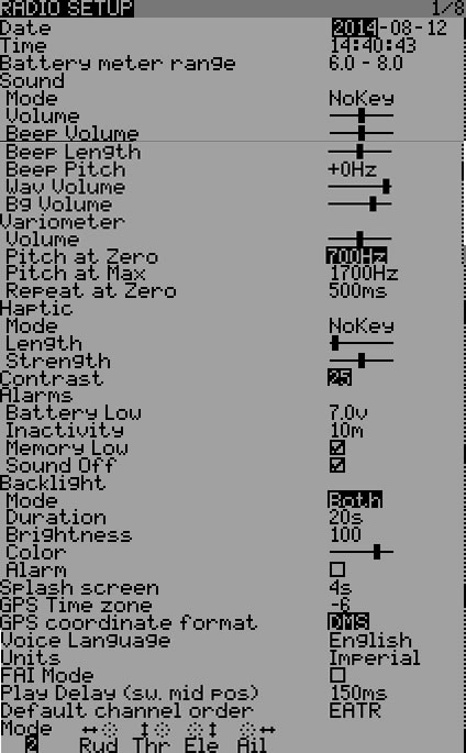

1 - How many cells is your battery ? 2S, or 3S? ANd what is the voltage once it has charged?
2 - I think that maybe your low voltage alarm on your radio is set too high, maybe for a 3S and you are using a 2S.
Details on how to set the low voltage alarm on your taranis is here:
Thank you both for your help. I will check cell voltages this afternoon when I get home. This is a 2S pack, and the QX7 is alarming when voltage drops to 6.6V.
