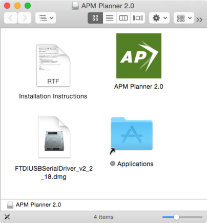

Lastly with either one of the mission planners, you can find the drivers within the install folder for each of them… It should be a file called FTDI USB.dmg

where can I find the install folder?
It will be wherever you installed the mission planner app. The .dmg driver will be included in the main mission planner download file.
