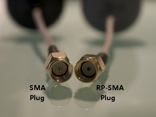

Alex just looking at the PRO58 RX Diversity Receiver do I need sma or rp sma? I have fatshark attitude v4 what’s the difference?
Ta
Cancel that just found the answer…
Thanks for watching :smile: Theres still a couple of video to come yet :slight_smile:
The PRO58 RX Diversity Receiver is the same module as I’m using at the minute.
Good module works well the ability to scan channels is really usefull as for the SMA or RP SMA…
That really depends on the attennas you already have.
If you have SMA attennas then you want the RP SMA module.
(I think that right)
