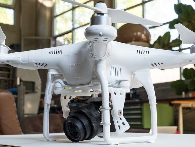

This is the mount I used . DJI Phantom 2, Camera mount for Panasonic GM1 by lb_supertec - Thingiverse. glued to a Iris Tarot mount

Thanks for the information about the camera mount for the Canon S100 or S90. I just placed an order with a local 3D printing shop for one (DJI Phantom 2, Camera mount for Panasonic GM1 by lb_supertec - Thingiverse). I already have a tarot gimbal for gopro hero3 for the IRIS (waiting for the IRIS+ upgrade kit to arrive), and I am wondering how you connected this camera mount to the gimbal. I know you mentioned glue - but is there a better way? Did you simply remove the gimbal controller and brushless gimbals and attach the 3D printed mount?

I printed this, 3DR IRIS mounting bracket for DYS 3 axis Gimbel by Ferdinand128 - Thingiverse then used some 5 min epoxy. I have the developer Iris so you will have to check to see things are compatible, A bit rough but works really well. .
