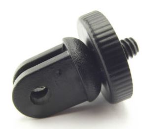

So pleased, got my new Iris today. I would like to fit my Canon s100 so got this as an experiment:-

Well, I fitted the adapter today, just need some decent weather for testing.
Thanks for sharing the pics
! Looks good
It should work fine with the camera tilted down, but just take some care on your first flight as I am not sure how far that camera will shift the COG forward.
