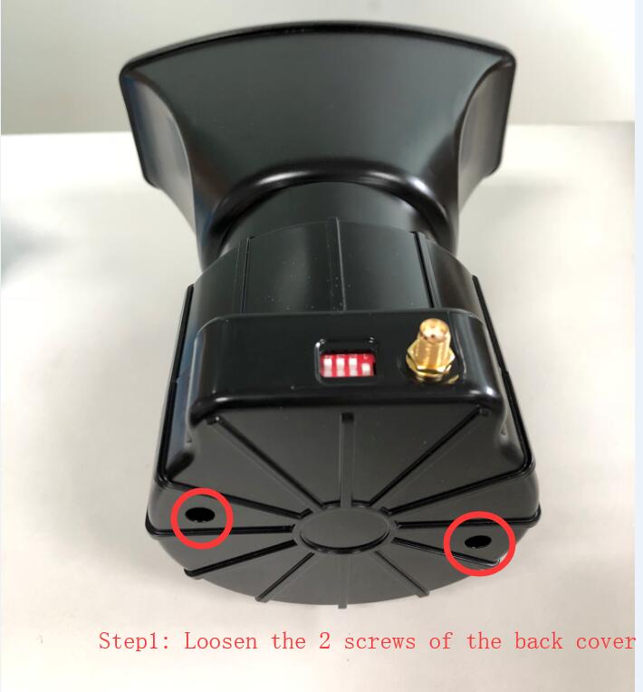

  1. Open the back cover after removed 2 screws.

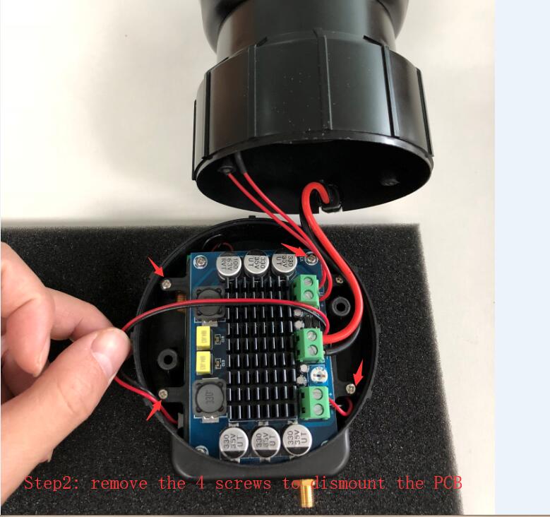

  2. Disboard the main PCB board after removed the 4 screws.

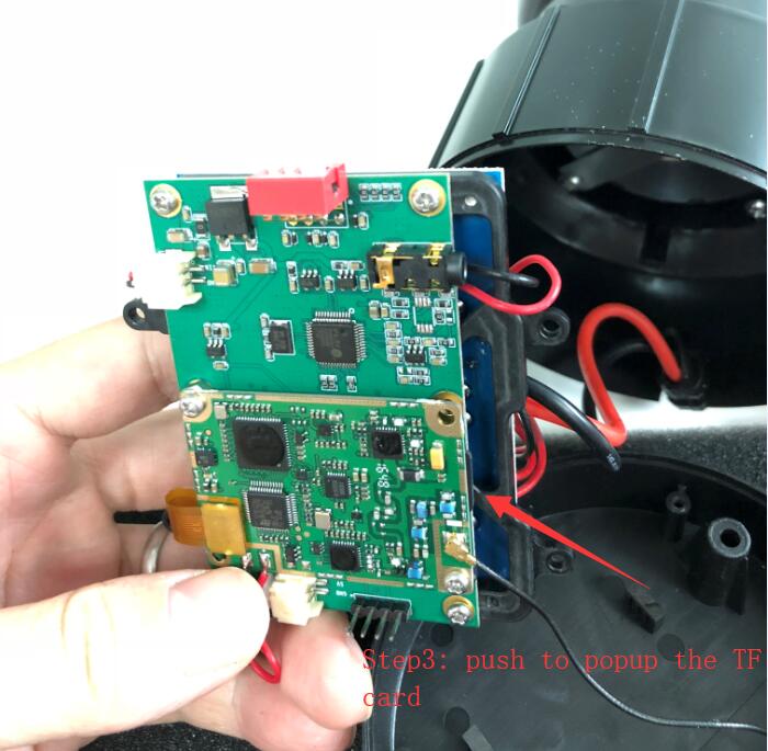

  3. Push the TF card and popup it.

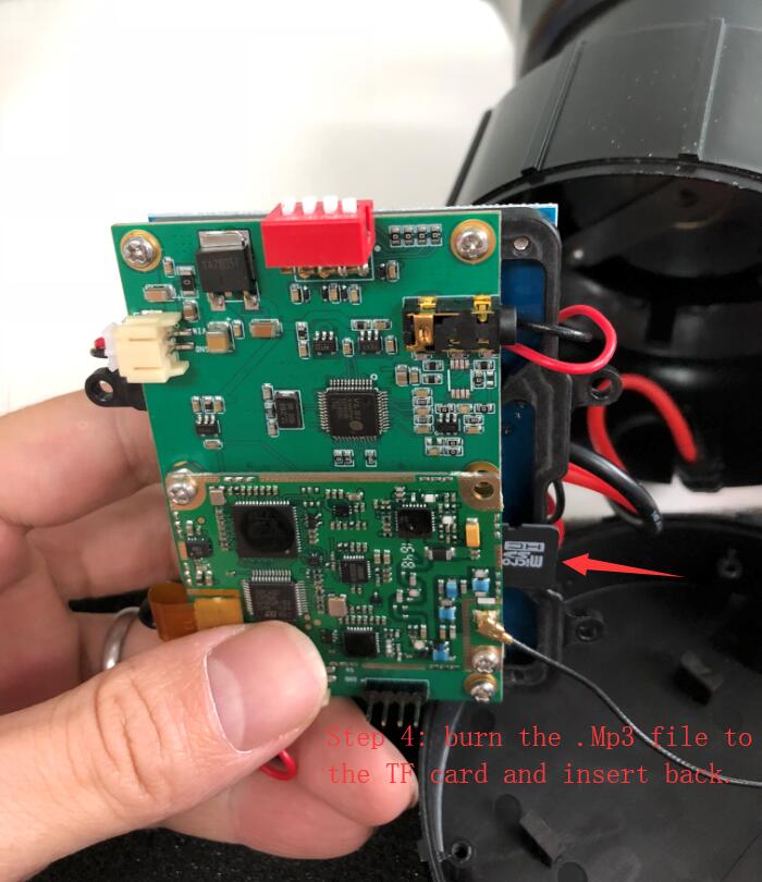

  4. Copy the sound file to TF card from PC, and install the TF.

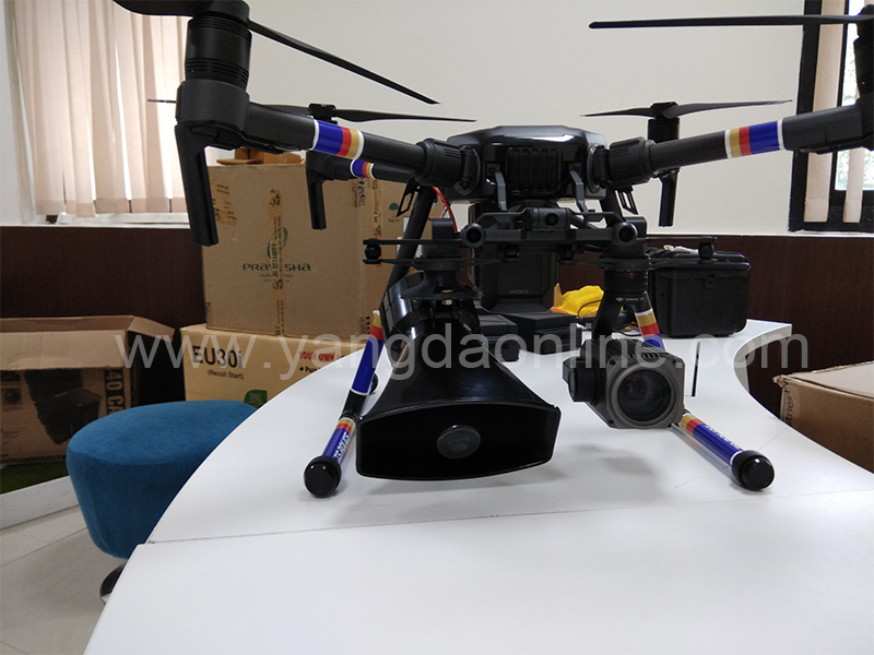

What’s more, with a 3D printed connector, the speaker can be mounted
on DJI M210 directly.
