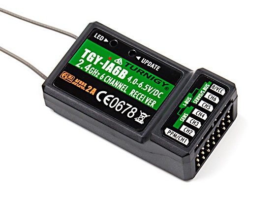

what about this one, will it work?
yes but it is a large receiver the TGY-iA6C is smaller but either will work. make sure your transmitter is conpatable.
