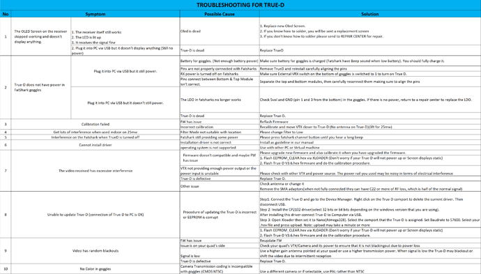

Here is a quick troubleshooting guide for you to follow to immediately fix, or narrow down the problem with your True-D Diverysity receivers. You should use this table before contacting FuriousFPV support to help solve your issue faster. You may even find a solution immediately using the table below.
TROUBLESHOOTING FOR TRUE-DRelated topics
