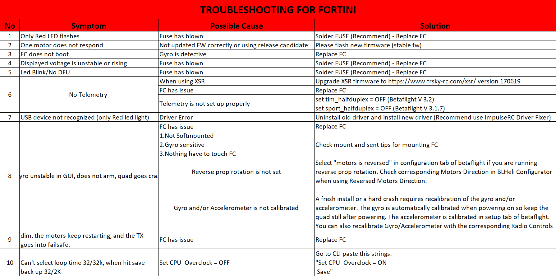

  • Fortini

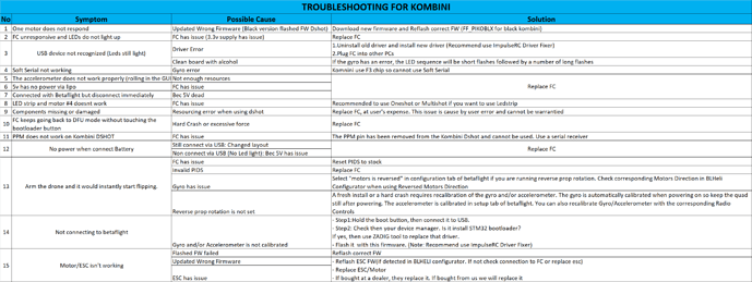

  • Kombini

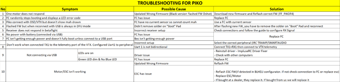

  • Piko

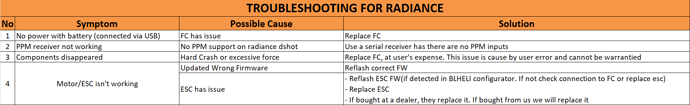

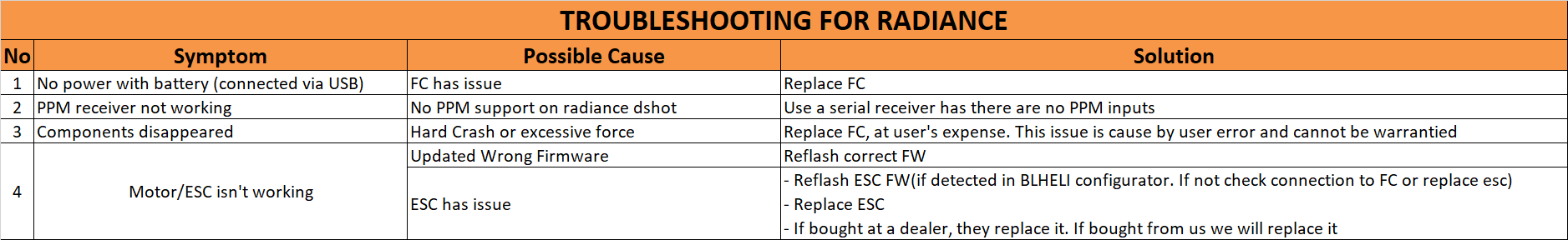

  • Radiance

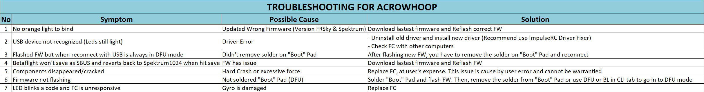

  • AcroWhoop

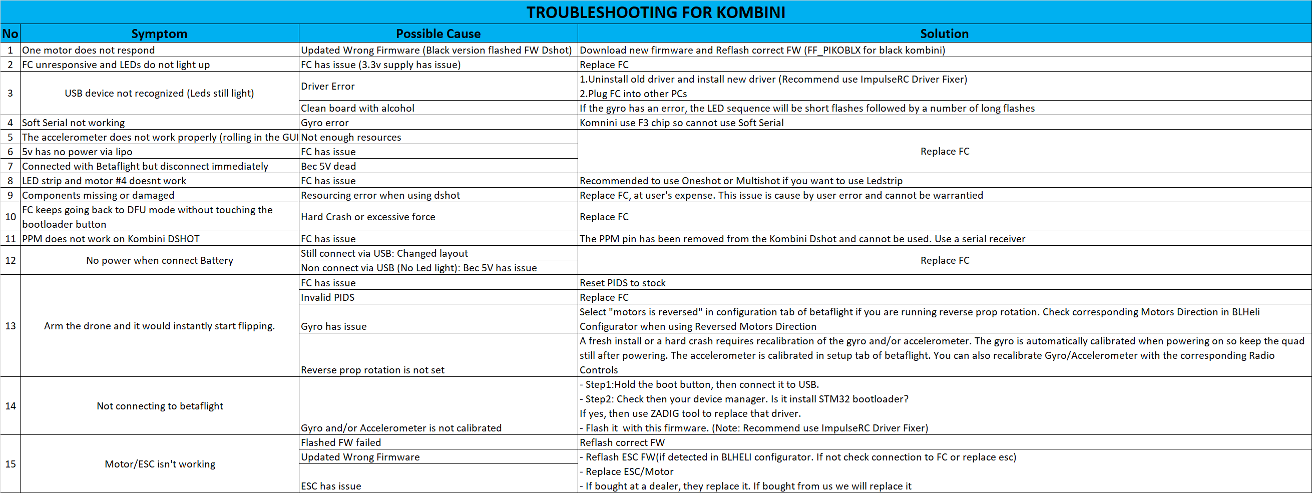

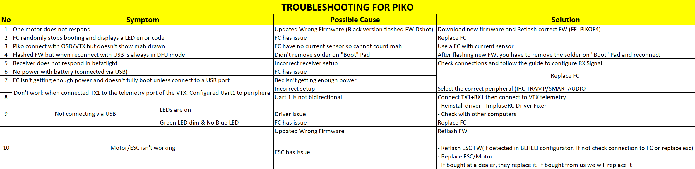

To view the full table click on the image, or if you have any questions/suggestions let me know so I can add them to the guide.
Fortini FC Troubleshooting Guide
Kombini FC Troubleshooting Guide
Piko FC Troubleshooting Guide
