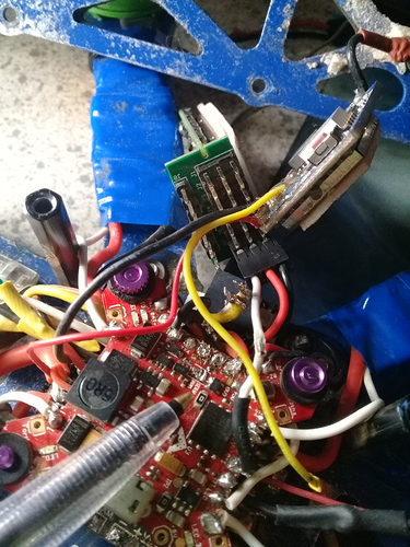

I need help with my fortini F4 FC it does not whant to reed my reciver for my flysky i10 TX i’m useing ppm on my TX plees need help

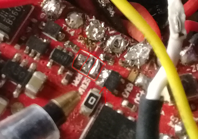

I’ve zoomed in on your image and it looks like you have bridged all three pads and have some solder on the other part.
Thank you i wil see to that
Nice find :slight_smile:
Hope that will solve the issue!
