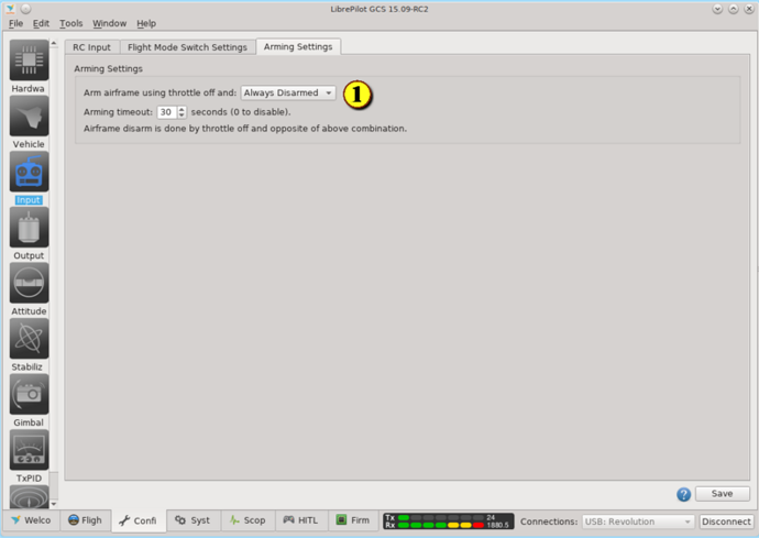

I have connected a X8R to a CC3D flight controller with OpenPilot. When connected via the GUI and using the Vehicle Set Wizard, every thing works. When I try to make the motors arm they do not. I am unsure what connections are required from the Rx to FC and what mode to use. I would like to use one for the main channels.

However if you use the app and go to Input section you will see a arming settings tab where you can see what method of arming you have set. My guess is that there is an odd arming method setup there.
Otherwise it could be something like one of the channels are reversed?
All sorted but had to go back to 1 wire per channel, could fathom how to get the subs to work.
